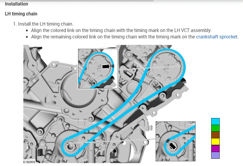

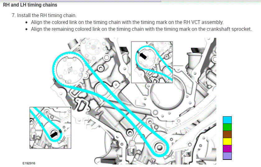

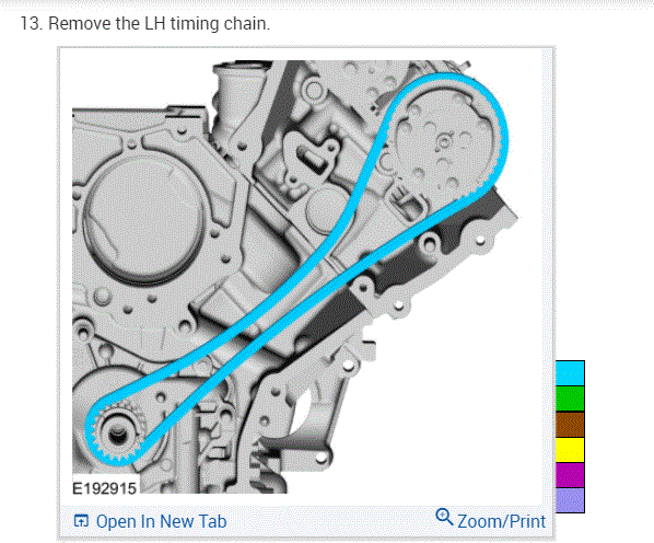

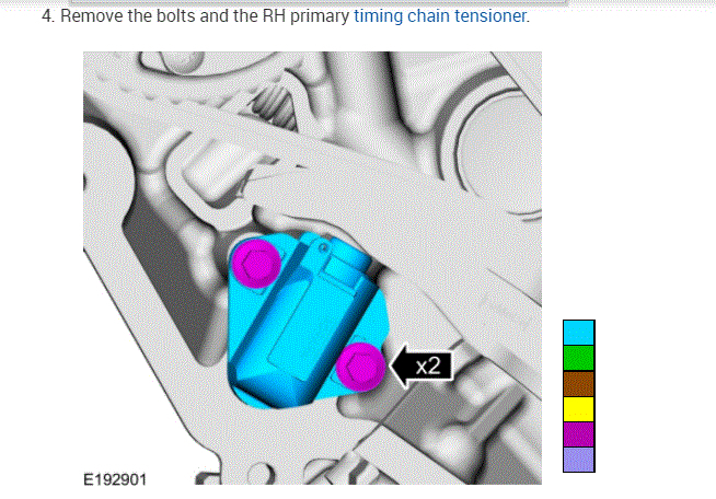

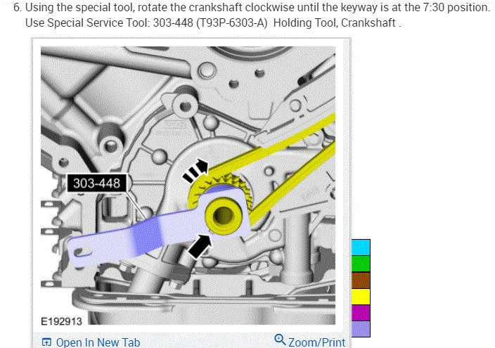

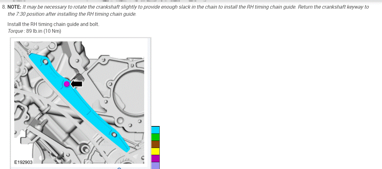

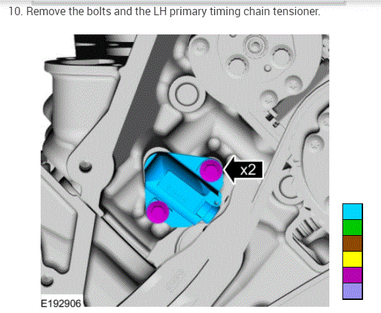

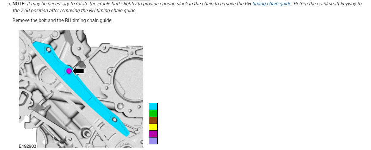

When removing the cam phasers/sprocket. Do the timing marks have to line up with the colored link? I have read the repair manual. It helps and doesn't. Thank you
