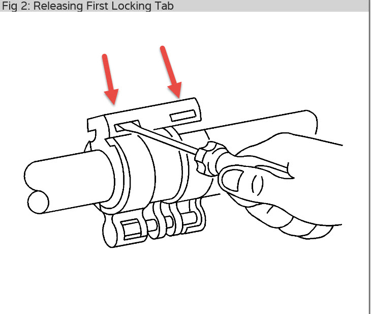

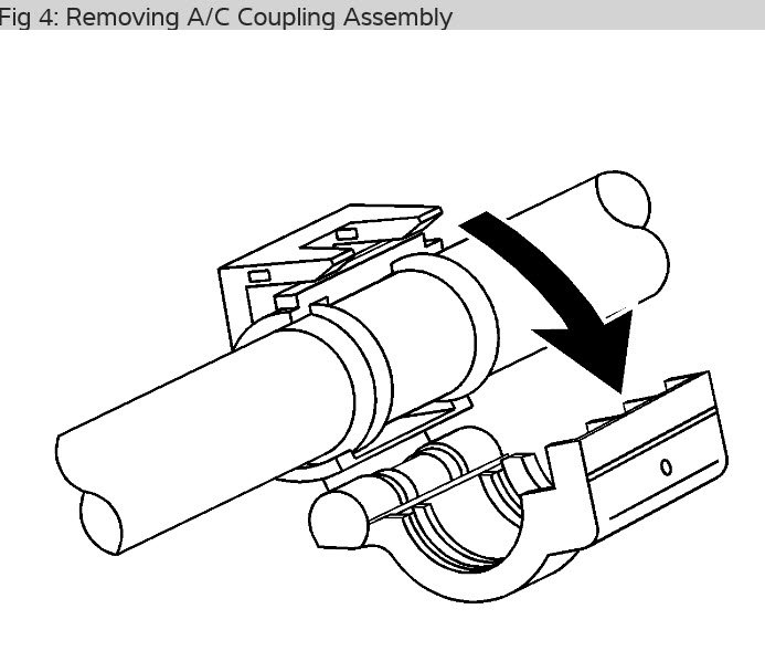

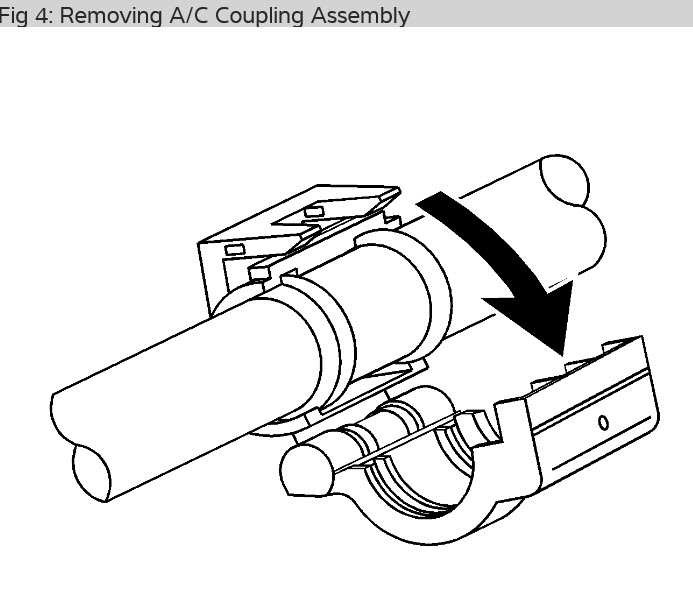

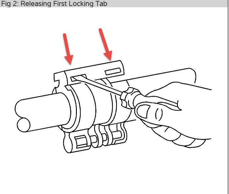

there are no A/C lines to radiator if you are trying to take A/C lines off then it is the condenser not radiator. if it is the oil cooler and transmission cooler there are lips that hold them in behind the plastic covers where lines go in. See pictures if talking about splitting lines to remove them.
