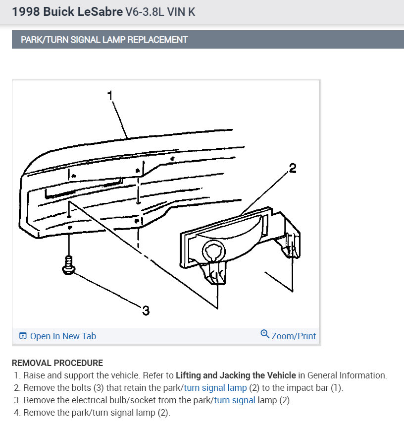

Yep, this is a tough one if you could upload images of what you are working on, I can help walk you through the repair. They show almost nothing in AllData and Mitchell 1 if you can believe that one.
Here is a generic guide to help:
https://www.2carpros.com/articles/turn-signal-bulb-replacement
