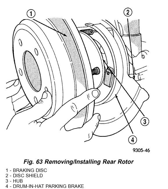

Once the wheel is removed, you first need to remove the brake caliper and caliper mount. Once they are removed, the rotor can be removed.
Here are directions for caliper and rotor removal and replacement. The attached pics correlate with the directions.

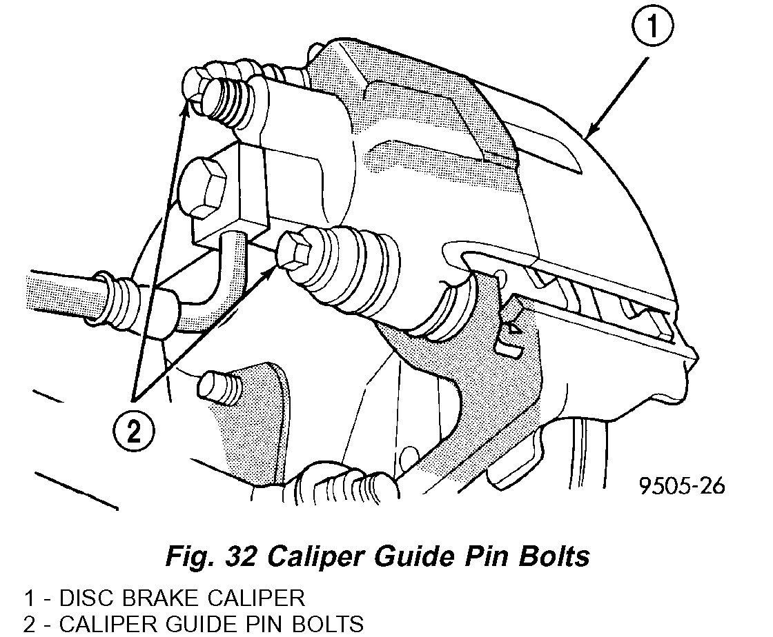

5. Remove the 2 guide pin bolts mounting the caliper to the adapter (Fig. 32).

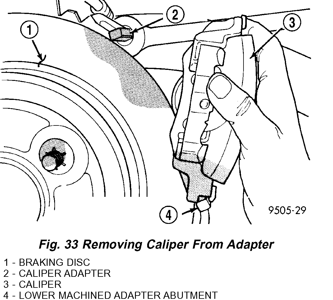

6. Remove caliper from adapter and rotor by first rotating top of caliper away from the adapter, then lifting the caliper off lower machined abutment on adapter (Fig. 33).
REAR BRAKE ROTOR
REAR ROTOR
REMOVAL
1. Raise vehicle.
2. Remove rear tire and wheel.
3. Remove the caliper and shoes from adapter and hang out of way.

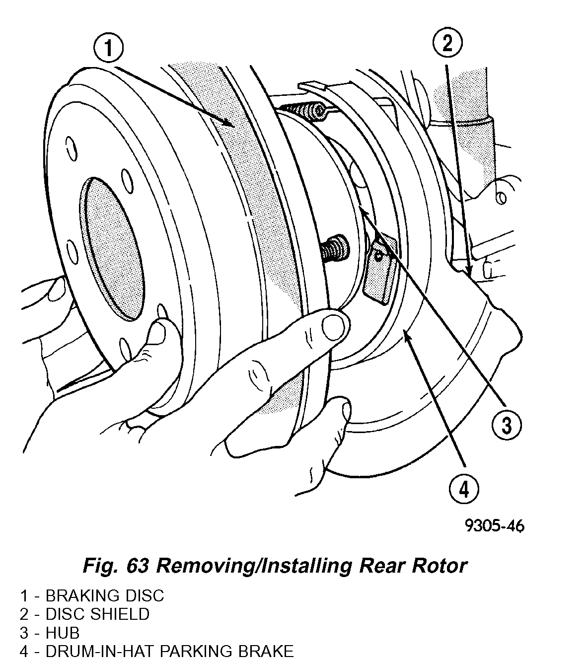

4. Remove any clips on the wheel mounting studs.
5. Remove rotor from hub (Fig. 63).
INSTALLATION
1. Install rotor on wheel mounting studs (Fig. 63).
2. Install caliper and shoes on vehicle.
3. Install wheel and tire assembly.
4. Lower vehicle.
