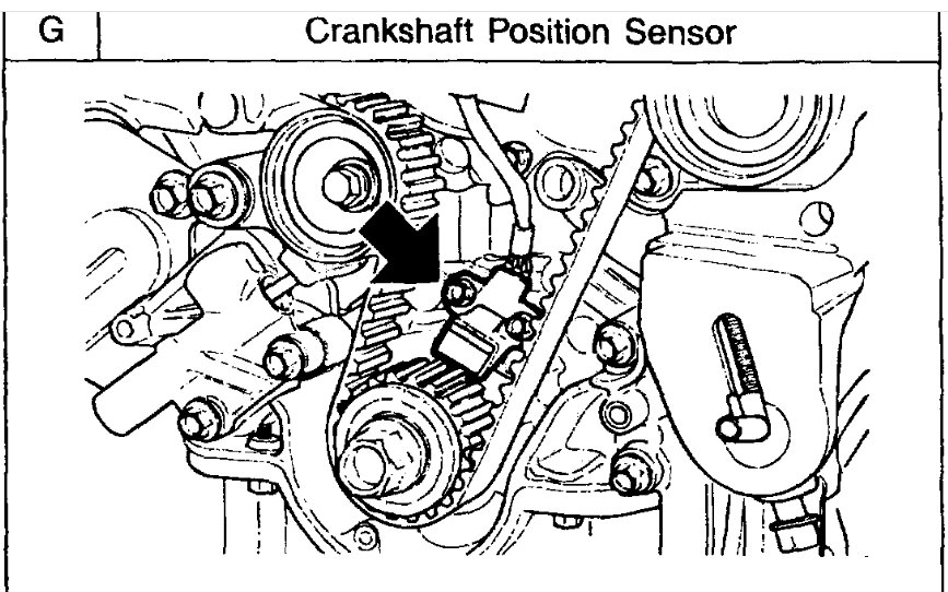

This vehicle doesn't have a distributor for the ignition system. When you say engine speed, that leads me to think you are referring to the crankshaft position sensor. If that is correct, I attached the directions below for replacing it. If that isn't correct, let me know.
Note: to access the sensor, the timing belt cover will need to be removed.
See pic below.
