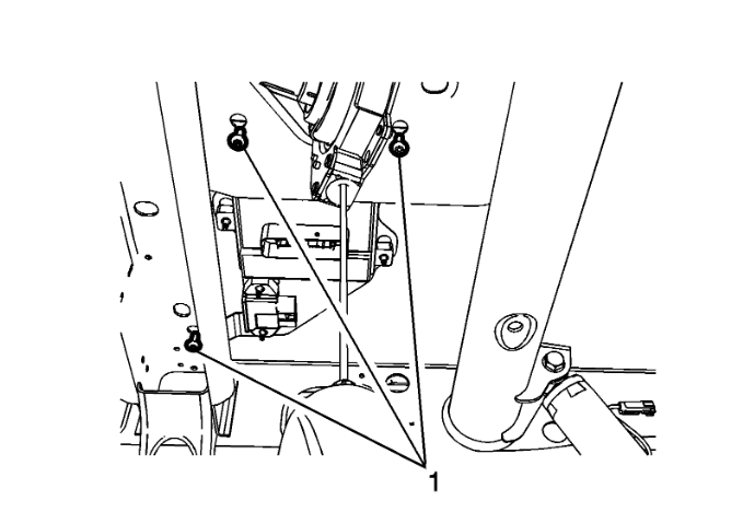

module
Removal Procedure
1. Place the ignition switch in the OFF position.
Note: Do not remove the spare wheel hoist.
2. Remove the spare tire and wheel assembly. Refer to Spare Wheel Hoist Replacement (See: Spare Tire > Removal and Replacement > Spare Wheel Hoist Replacement).
3. Raise and support the vehicle. Refer to Lifting and Jacking the Vehicle (See: Vehicle Lifting > Procedures > Lifting and Jacking the Vehicle).
4. Disconnect the trailer brake control module and trailer brake control relay electrical connectors.

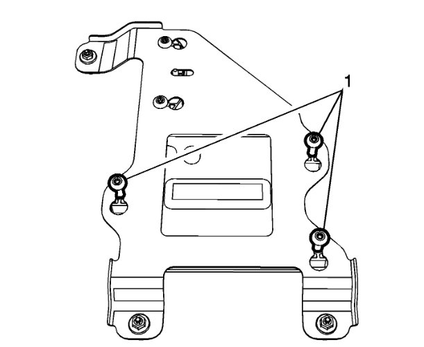

5. Loosen, but do not remove, the trailer brake control module bracket bolts (1).
6. Slide the trailer brake control module bracket toward the right of the vehicle and remove assembly from the vehicle.

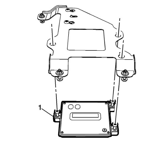

7. Loosen, but do not remove, the trailer brake control module bolts (1).
8. Slide the trailer brake control module (1) to remove the module assembly from the br

I posted the procedure and the pictures of the location in my previous post.
What is the code for the system? Just throwing a module at it is expensive if it is not the issue.
