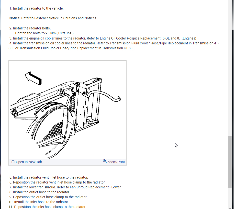

just want to watch a video if you guys have one on how to replace one on my truck?

Good afternoon,
I attached one for an Escalade which has the same platform as the Tahoe.

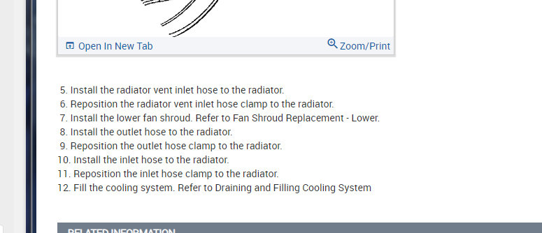

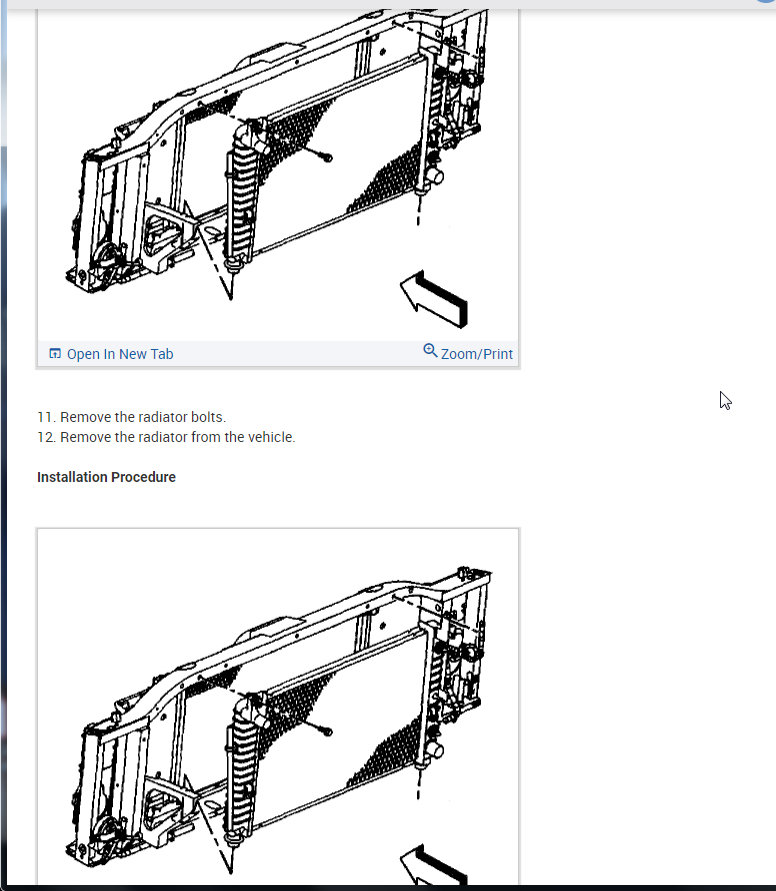

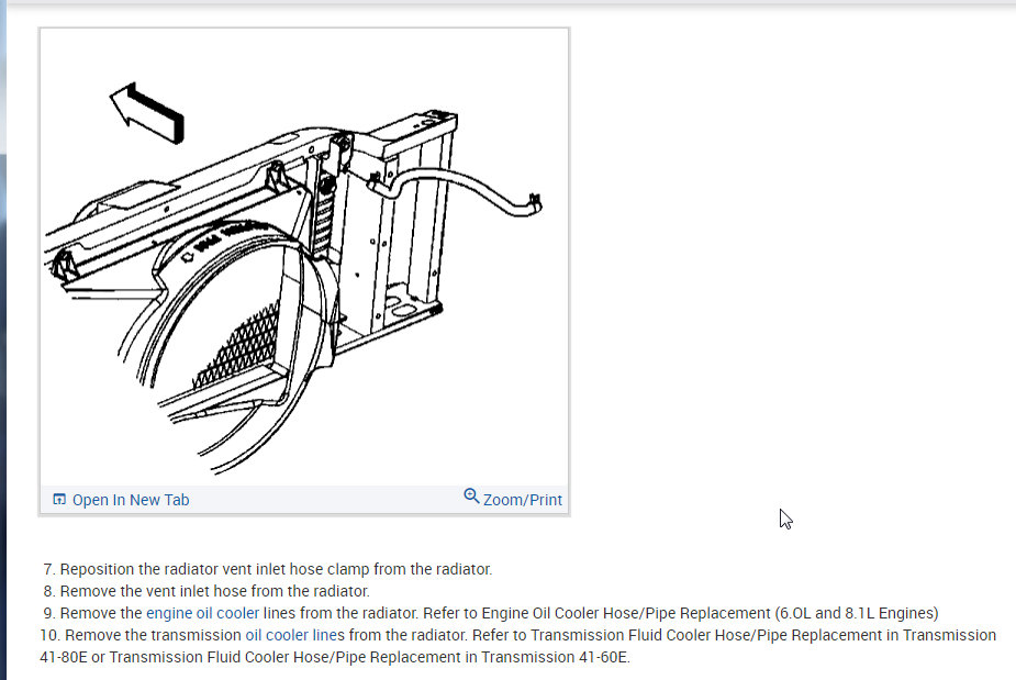

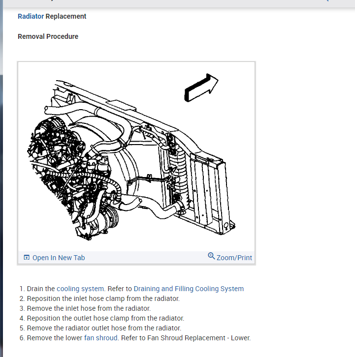

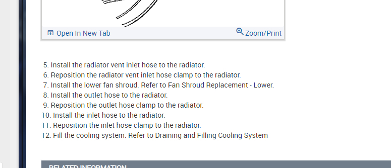

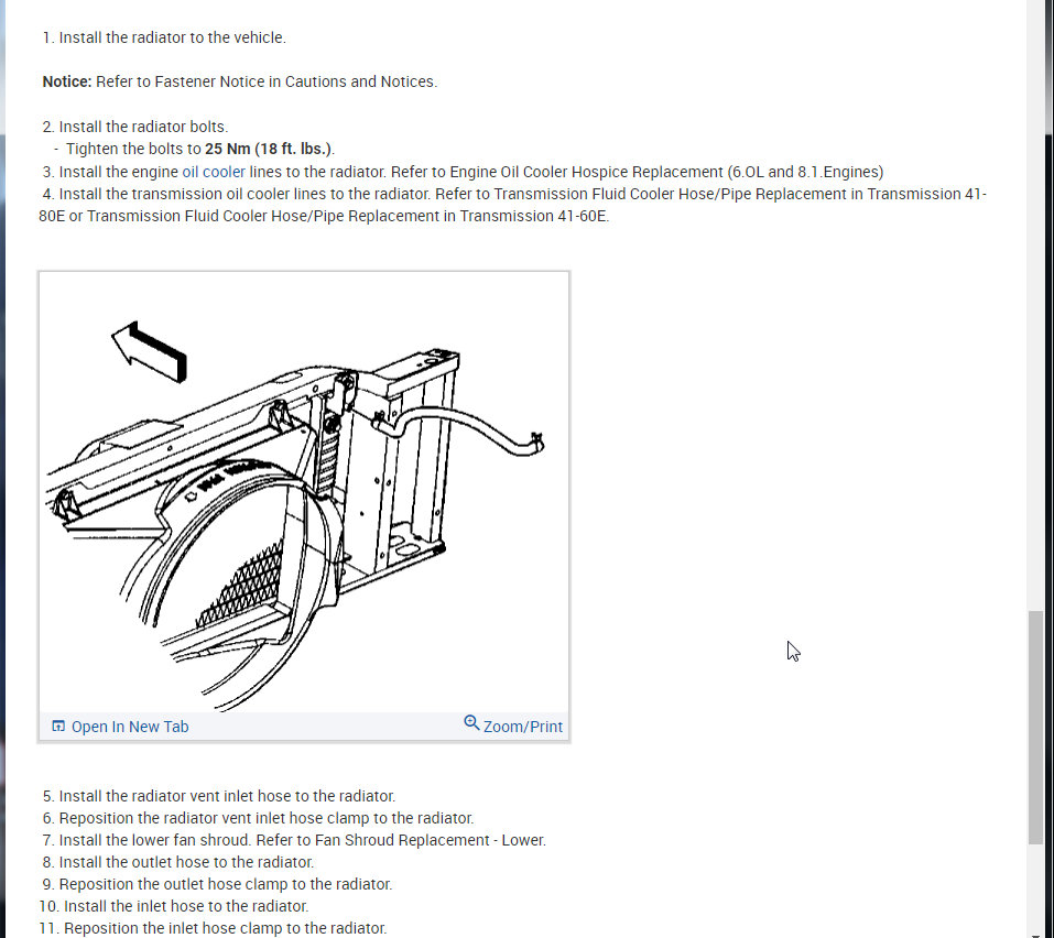

I am also attaching the process from the manual below on how to replace this as that should help as well.
Lastly here is a guide on how to replace a radiator as well. This will help in more general terms.
