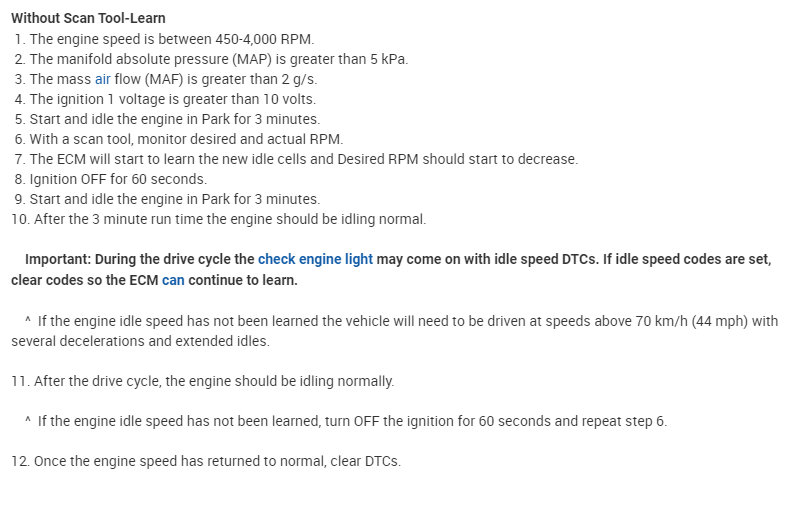

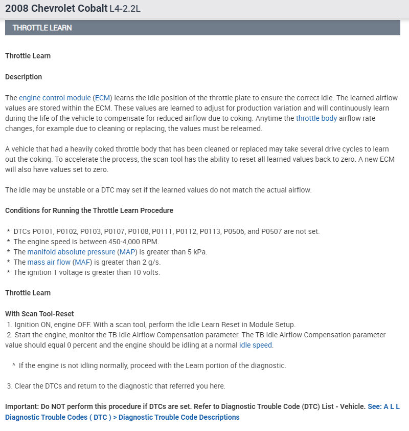

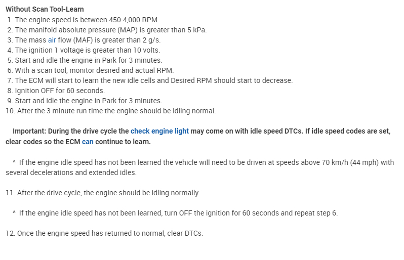

The new throttle body has to go through the re-learning process in order to function properly.
This requires specific step to be performed in specific order.
I have attached the process for both with scan tool and without scan tool.
Thank you.
