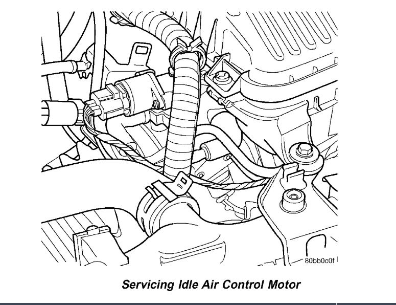

Replaced MAP sensor and TPS.. now wont even stay idling weather hot or cold. new code for IAC malfunction, but i replaced that 3 weeks ago and fixed itself for a bit.
Dec 30, 2019 at 8:37 PM
CERTIFIED EXPERT
52,796 POSTS
Need the code number.
Did you check the fuel pressure.
Dec 31, 2019 at 12:26 AM
DJGAZELL
MEMBER
7 POSTS
Everything working now. clogged air valve.. but now when i start it it idles fine for 3 seconds then raises to 1,500/2,000 rpm's. i replaced IAC 3 weeks ago so it shouldn't be that. no engine light.
Jan 1, 2020 at 2:39 PM
CERTIFIED EXPERT
52,796 POSTS
Pull off the wires to the IAC and see if the idle is normal. What valve was clogged?
