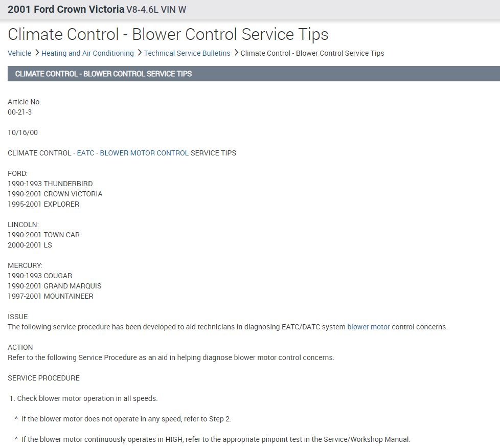

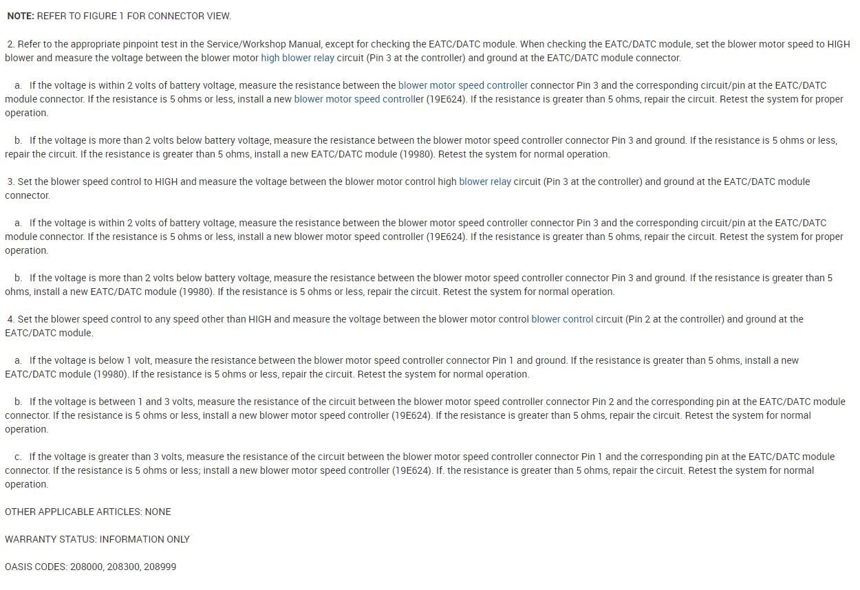

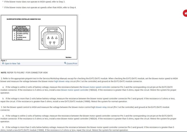

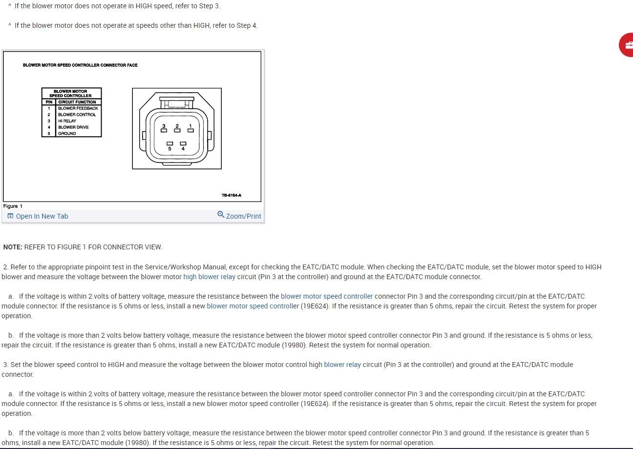

Does this have electronic automatic A/C? Or manual A/C switches?
These are clips of a Ford TSB to help with diagnosing Electronic Automatic Temperature Control.

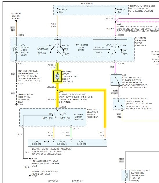

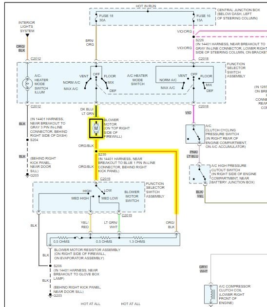

Is it possible that the power and ground wires are on backwards? If this happens the blower would run in reverse.
Does the fan sound 'normal' on high speed like its spinning really fast? Or does it sound slower?
Can you check the two wires going into the blower for voltage and ground? A multimeter would work best. See if you have over 12 volts at the blower connector with the engine running and the blower set to high speed.
Also, feel the 2 connectors and crimps at the blower, do they feel hot? If they are hot it can indicate resistance to electrical flow.
I've attached the wiring diagram for the blower in your car.
Jul 30, 2021 at 6:47 AM

It was the power wires sending electric to the blower motor where I had to splice the new pigtail wires were backwards it work perfect now. thanks so much.
