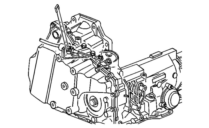

3. Remove the trans-axle shift cable from lever and bracket from the trans-axle.
4. Disconnect the trans-axle wiring harness connector and disconnect the harness retainer from side cover stud.

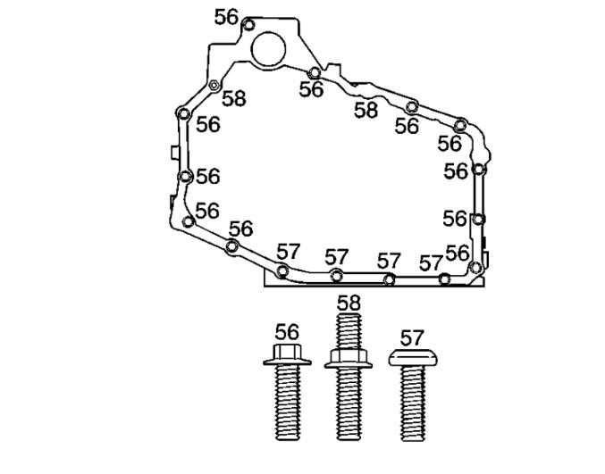

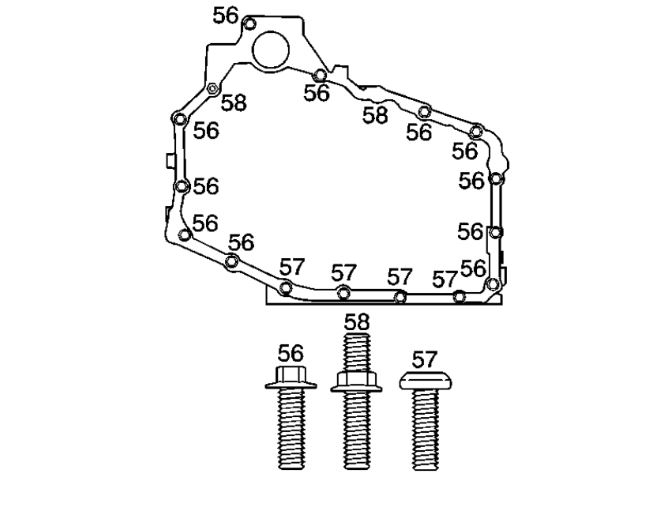

6. Remove the top case side cover bolt (56, 58).

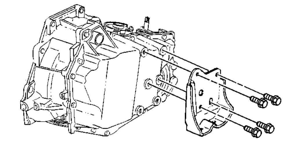

26. Remove the transaxle mount bracket bolts and the bracket from the trans-axle.

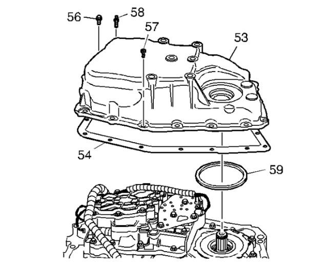

27. Remove the remaining case side cover bolts (56, 57, 58).
28. Remove the case side cover (53).
29. Remove the case side cover gasket (54).
30. Remove the case side cover O-ring (59).
