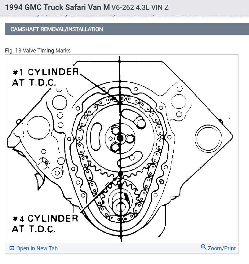

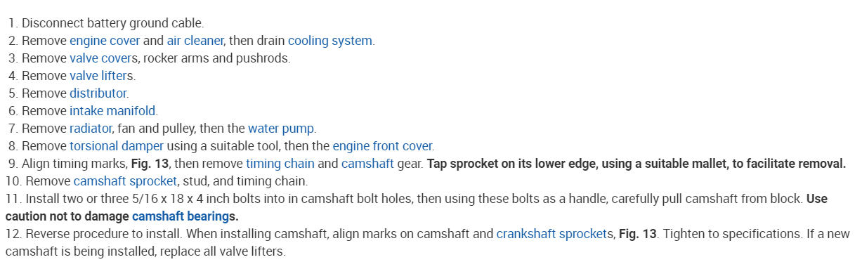

I have a few detailed questions regarding how to with engine in the vehicle.Does the oil pan need to come off in order to remove and re-install the timing cover? Do the four water pump bolts go into the water jacket of the engine? Or do they just terminate into threaded bosses?
