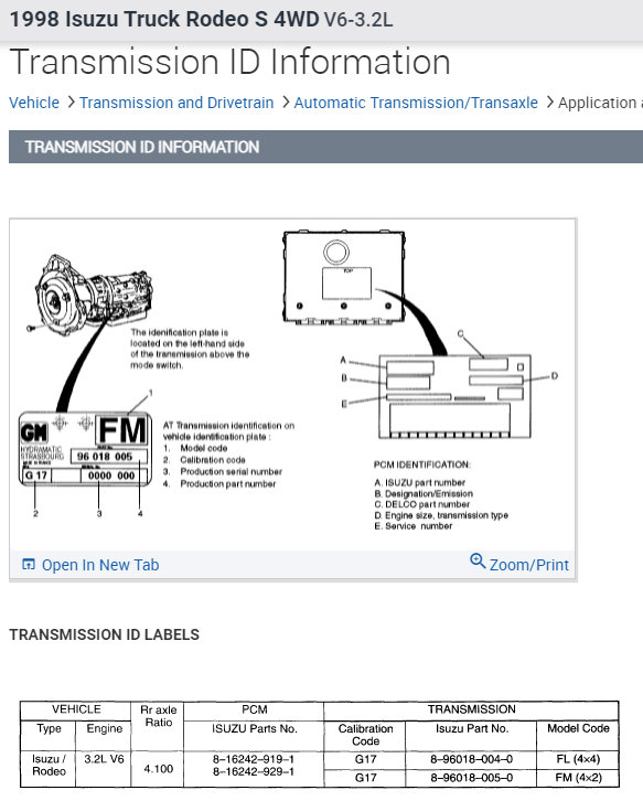

The transmission in my truck has gone out. I have a 2002 4x2 Rodeo with a good transmission and I need to know if I can use the 2002 in my 1998. Also need to know if the 4x4 vs the 4x2 drive train will be a problem?
