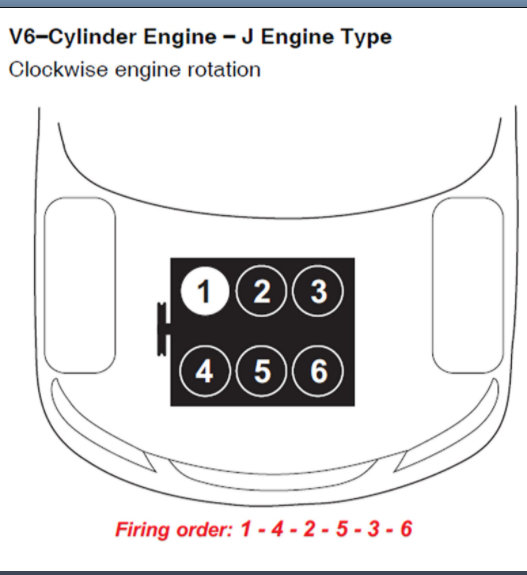

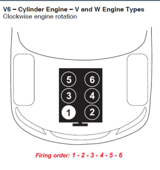

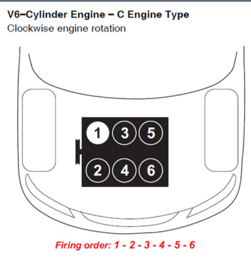

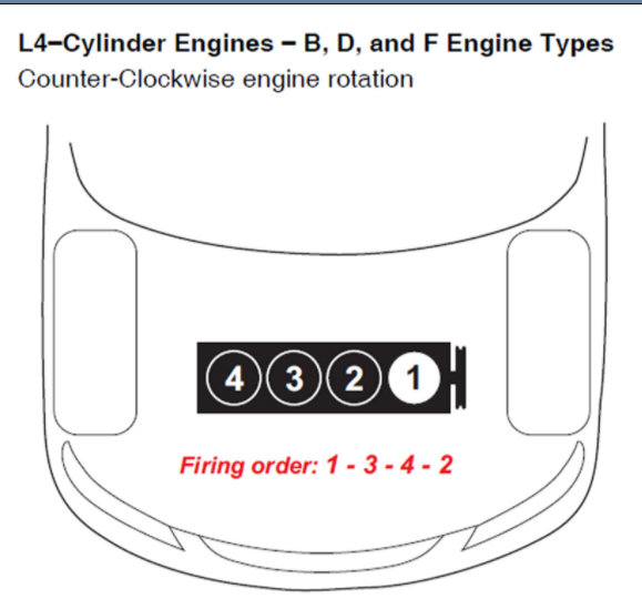

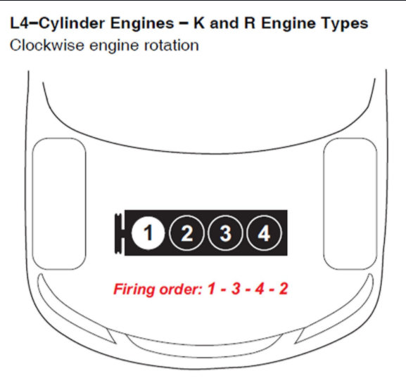

I don't know what cable goes to what cylinder.

Not to sure exactly what engine is in your car as there isn't a 1.2L- V6 engine available. if you can provide us with a VIN - vehicle identification number I can find out what exactly you have. I've attached firing order pictures below to get you started. Let us know and we'll go from there. Hope this helps and thanks for using 2CarPros.
