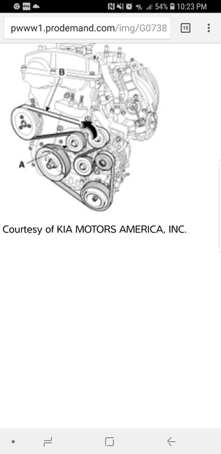

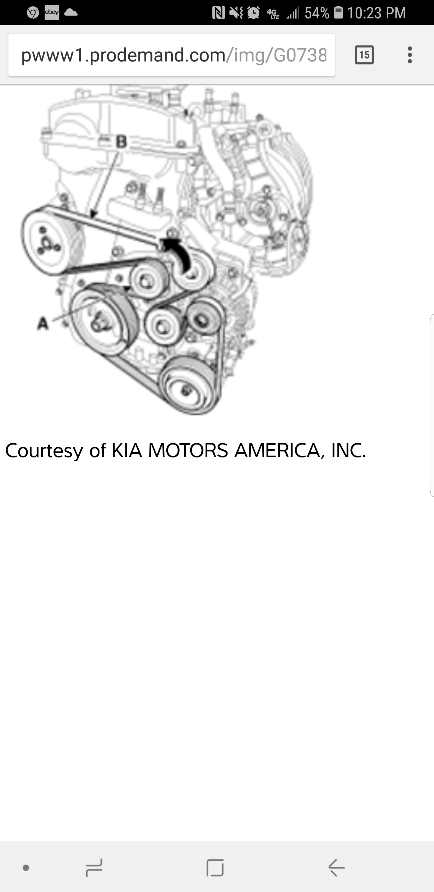

I need to replace the serpentine belt. Do you have a diagram where serpentine belt goes and where to loosen tension-er?

I posted a guide on how to replace the belt. I also posted a belt routing diagram. In the diagram it also shows which way to move the belt tension-er to release the belt tension. You can use a wrench or a ratchet with a socket. Let me know how it goes.
