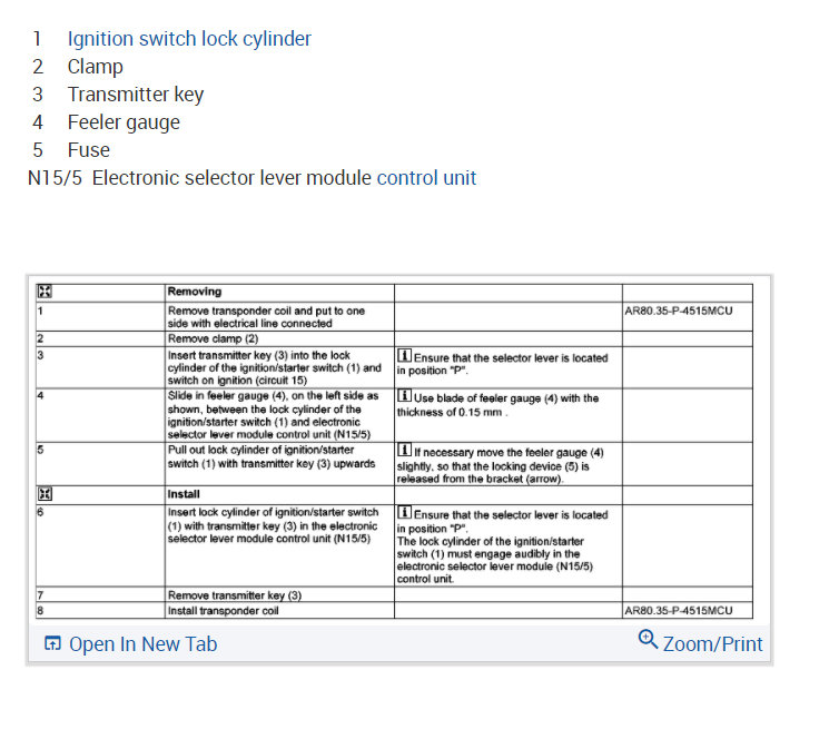

I purchased the car listed above with only one ignition key, which of course I lost it. I can't afford hundreds of dollars to replace all the fob functions. is it possible to get a replacement key that just starts the car?
Dec 19, 2020 at 9:20 AM

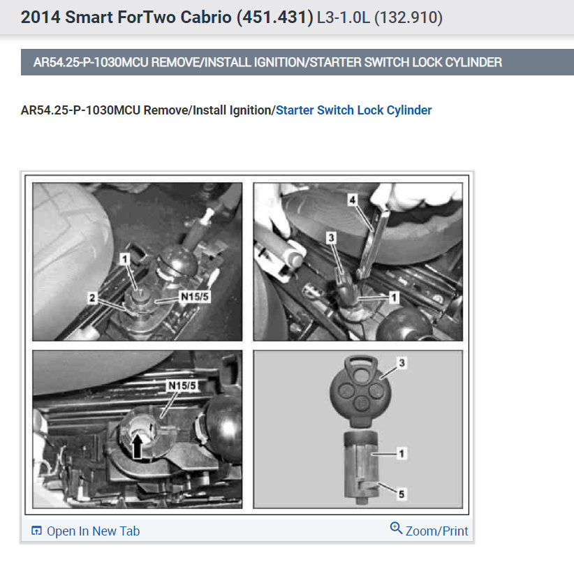

Here are the instructions on how to replace, the ignition key. Check out the diagrams (below). Let us know what happens and please upload pictures or videos of the problem.

I have a working ignition cylinder with no transmit key. If I follow these instructions I will have a second good cylinder with no transmit k key. Thanks for your efforts in any case. Bert

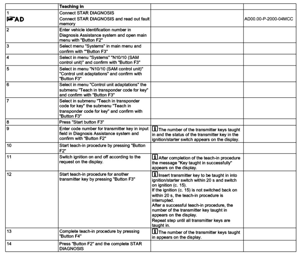

Got it. try these instructions in the diagrams below. let me know
