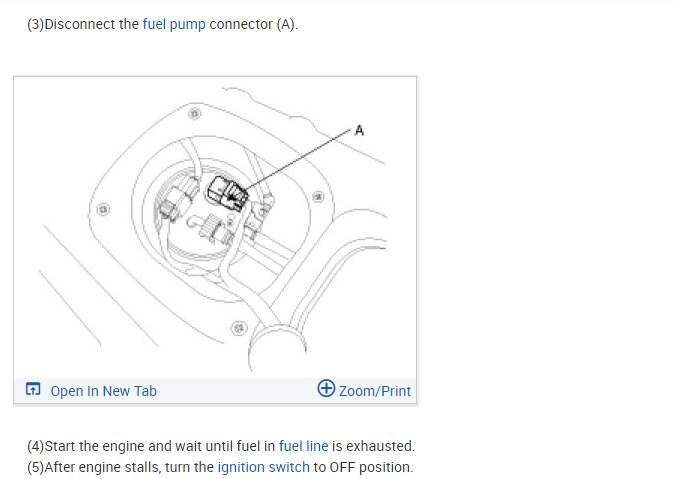

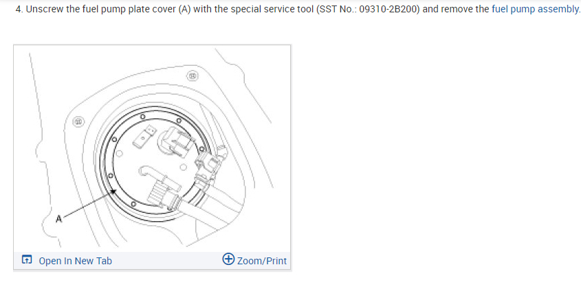

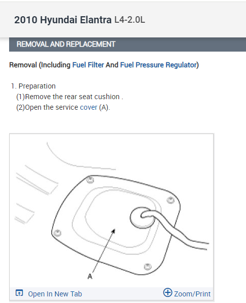

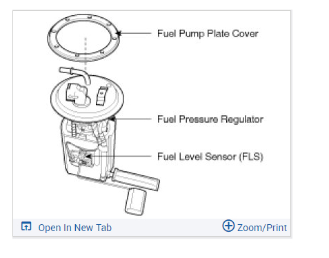

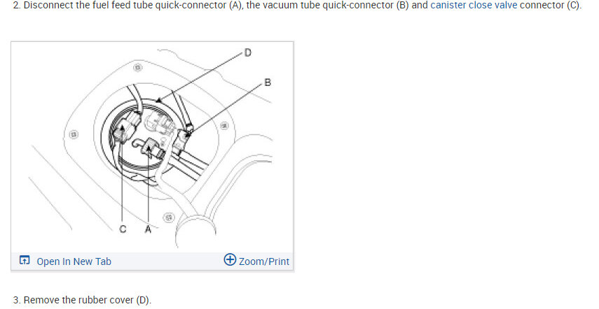

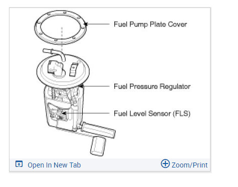

The fuel filter and pressure regulator are one unit and are in the fuel tank. They are part of the pump assembly.
You can easily access the pump from under the rear seat of the vehicle. There is a port to reach it under a cover.
I attached the directions below. Take a look and let me know if it helps or if you have other questions. Note: Most times, a filter will not completely stop the fuel flow. If you hear the pump run, chances are it has failed internally.
See pics below.
