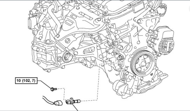

Why do they think it needs a crank sensor? Was there a code for it? Check your receipt for any information. The tech should have written a story.
https://www.2carpros.com/articles/how-a-crank-shaft-angle-sensor-works

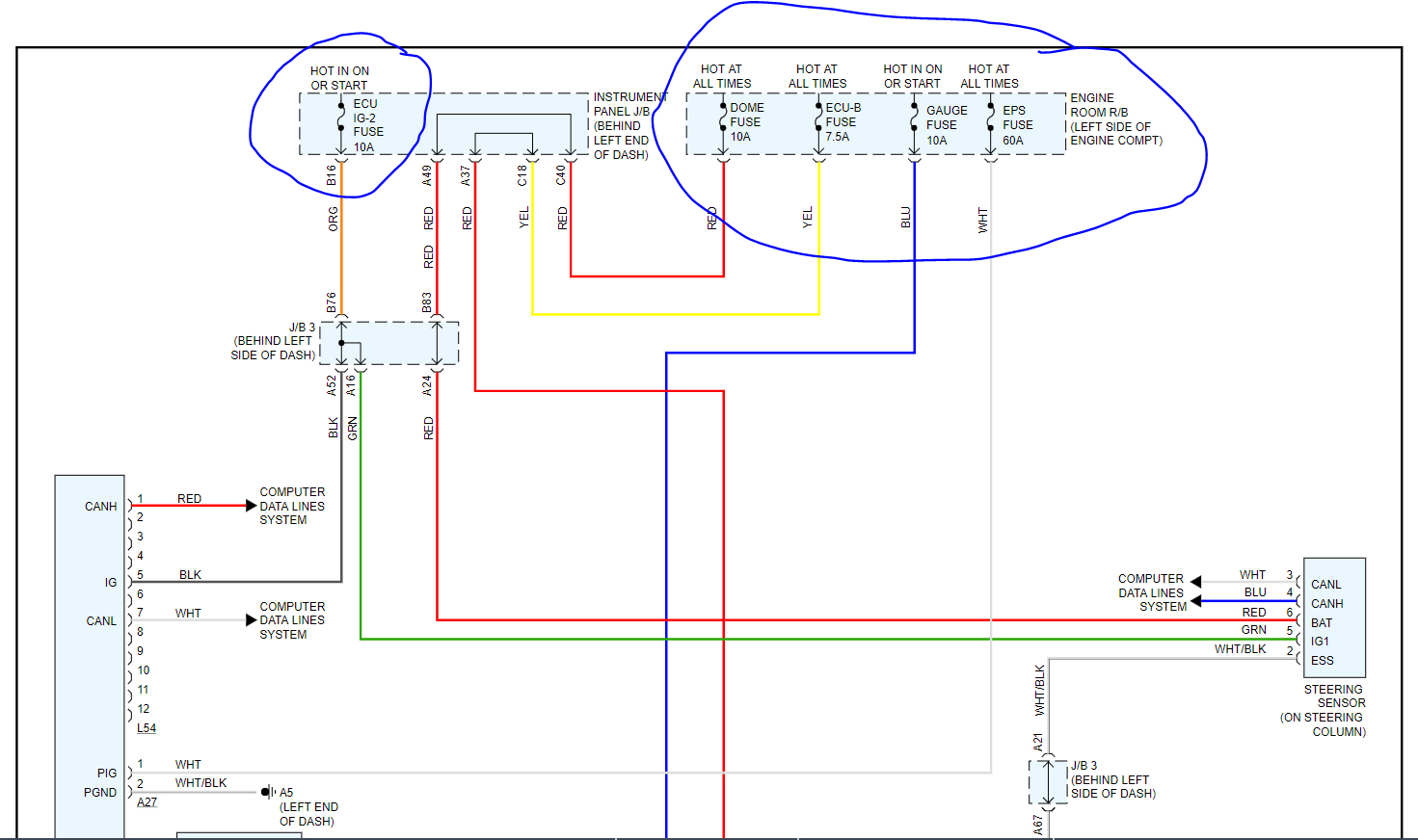

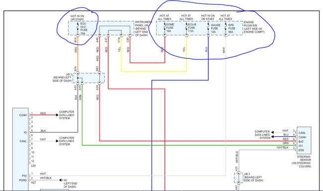

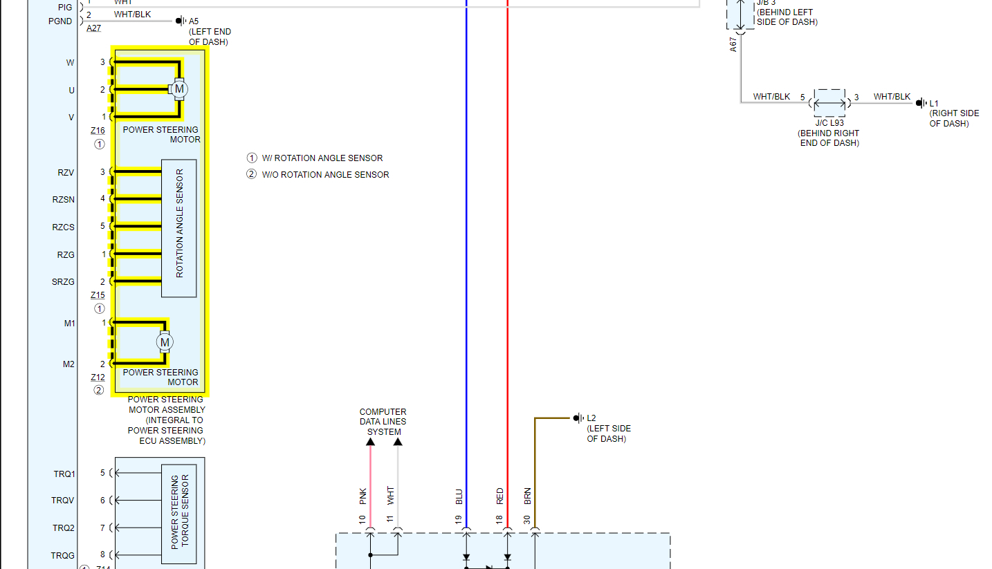

The steering is electric. When there is a fault, it sets a code as well.
I attached the diagram for you but you will need an advanced scan tool to monitor that system. Check the fuses I circled to sure they are good.
