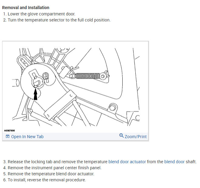

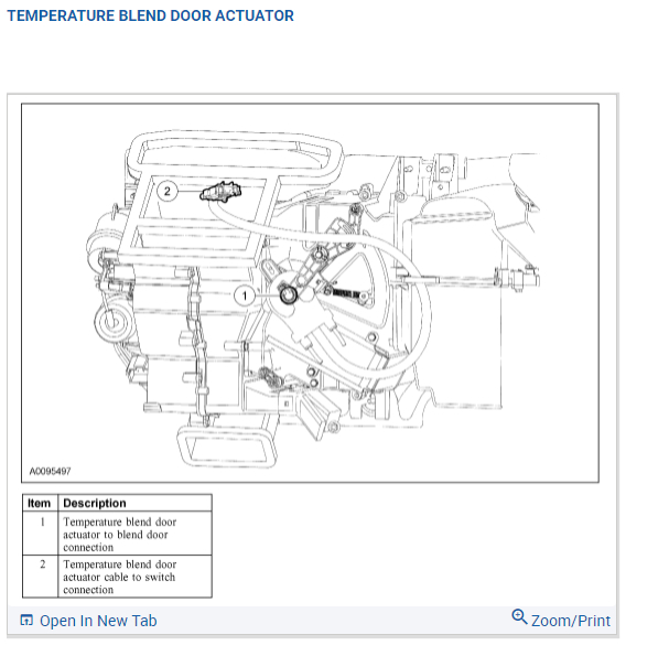

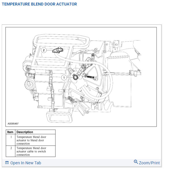

I need to know the location of AC/heater vent blend door actuator for the vehicle listed above. If you can would you show me any images of the location?

The blend door actuator should be located behind the glove box compartment.
Here is a guide that will help with replacing the blend door that will help with this as well:
Also, see the attached pictures from the manual which will help as well. Let us know if you have questions.
