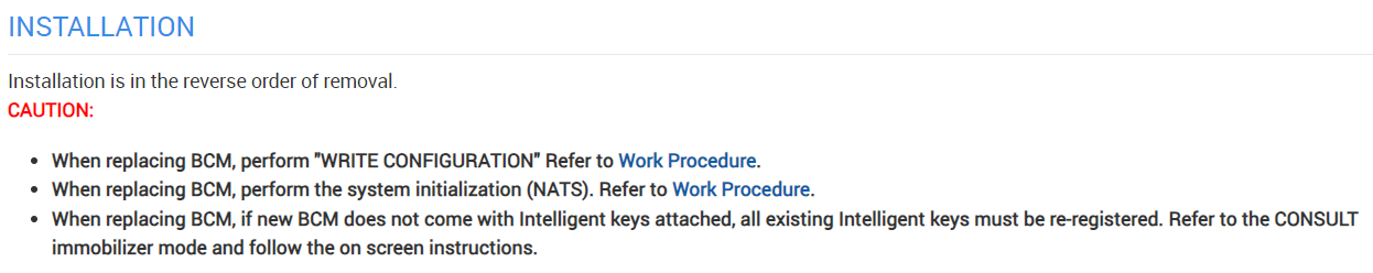

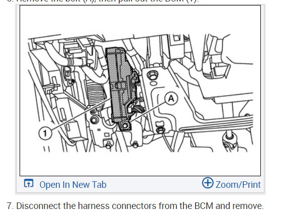

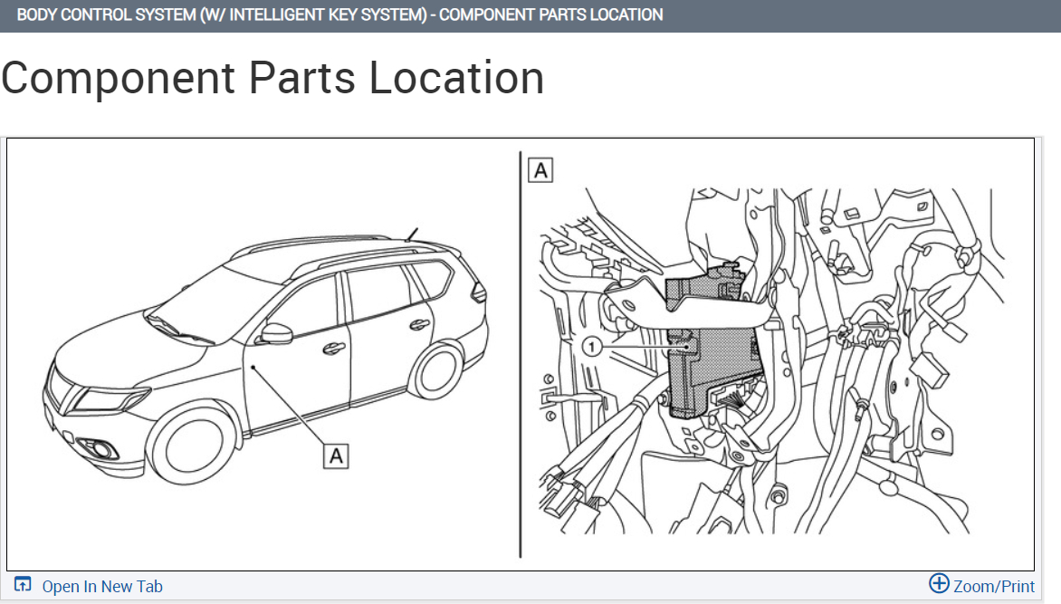

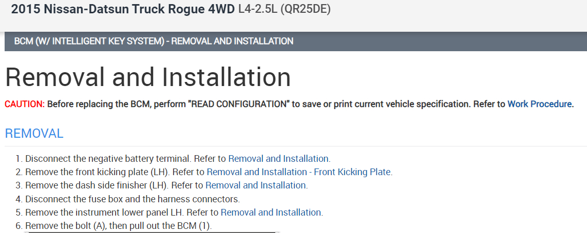

Sure, the BCM is up under the dash on the driver side, here is the location of the BCM and how to change it out, you can get a preprogrammed unit by searching Google or Ebay so no programming will be required. Have your VIN number ready. Check out the images (below). Let us know if you need anything else.
