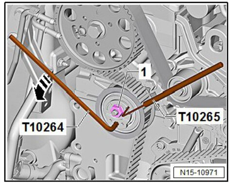

Yep, I can help, What happens is the timing belt starts to wear out including the tensioner and this creates the codes due to the (slop) in the system. If you have a sensor high or low code this is the problem. If the timing belt is worn or lose this will cause these codes. You can remove the timing belt cover and check the belt tension and condition. If the engine is making a slight rating sound at idle this can be the problem. Check out the images (below). Please upload pictures or videos in your response

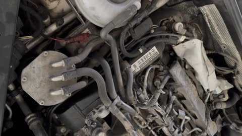

Knowing what I know about cars is fairly advanced, it is possible they just don't know, but the noise at idle should have gave them a clue. It could have been a new tech looking at it. We will know more once I hear the video.
Aug 5, 2025 at 8:31 AM
KALLE
Hi again, This is the best I was able to record. The weather was windy most of the day, and it wasn’t possible to film it in an isolated place due to work. The sound I was talking about is strange — maybe it’s a fan noise, a belt, or something else, I’m not sure. There’s a sound that doesn’t seem like it’s just the engine sound. If you’re able to distinguish it, I don’t know if it’s related or not, but this is the best I could manage. As for the timing-belt, a friend of mine has a workshop and will check it either tomorrow or the day after. Based on that, I’ll know whether the issue is from it or not.
Aug 6, 2025 at 11:45 AM
O ya!, I can hear the slop in the timing belt from the video, thank you for that. I am very confident this is your problem. Please try to get a video of how lose the timing belt it for the win!! :) Remember to clear the codes once completed.
