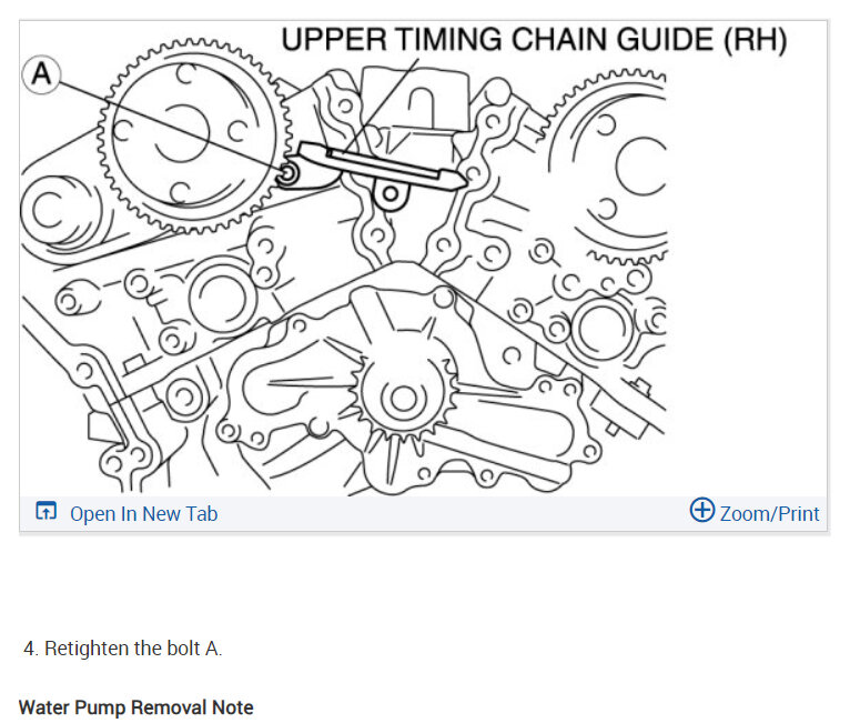

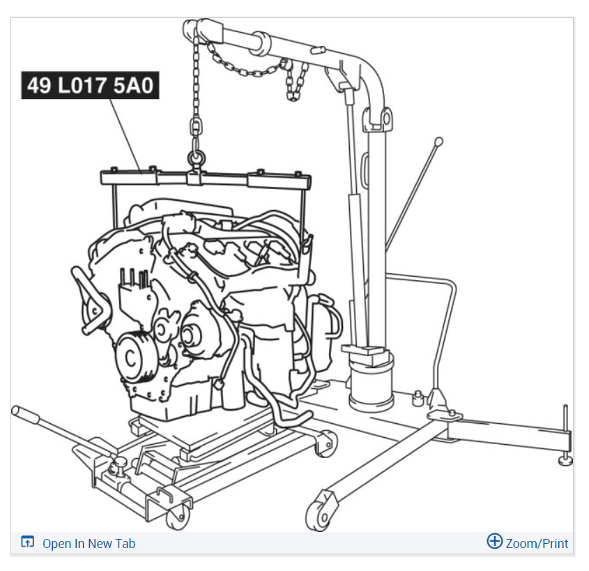

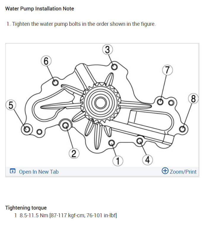

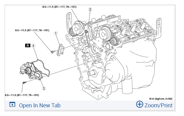

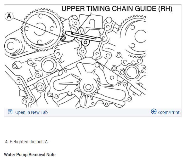

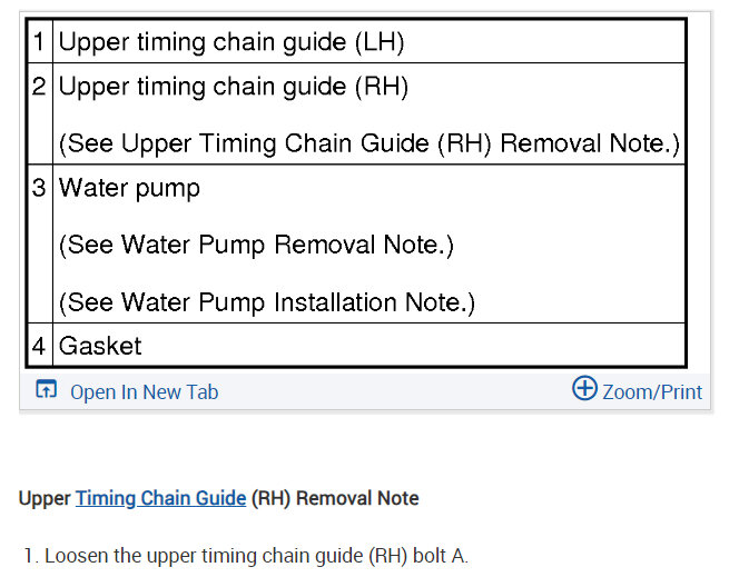

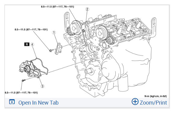

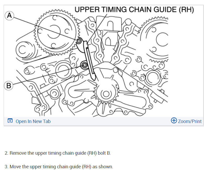

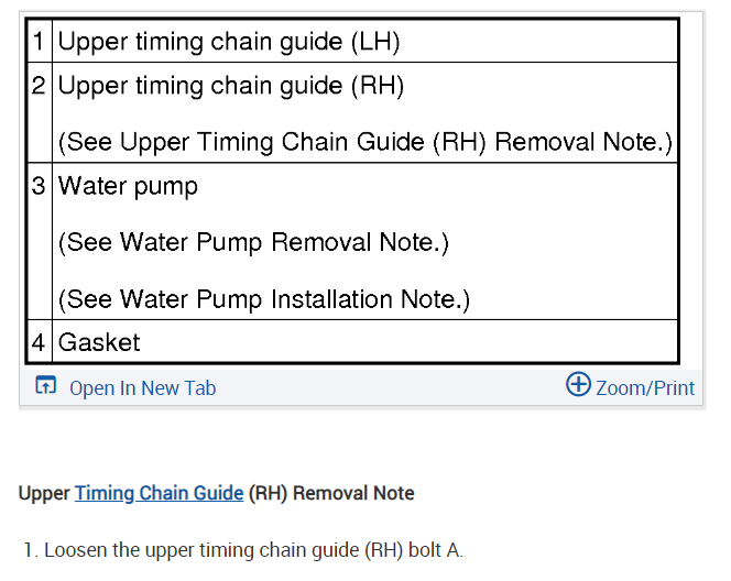

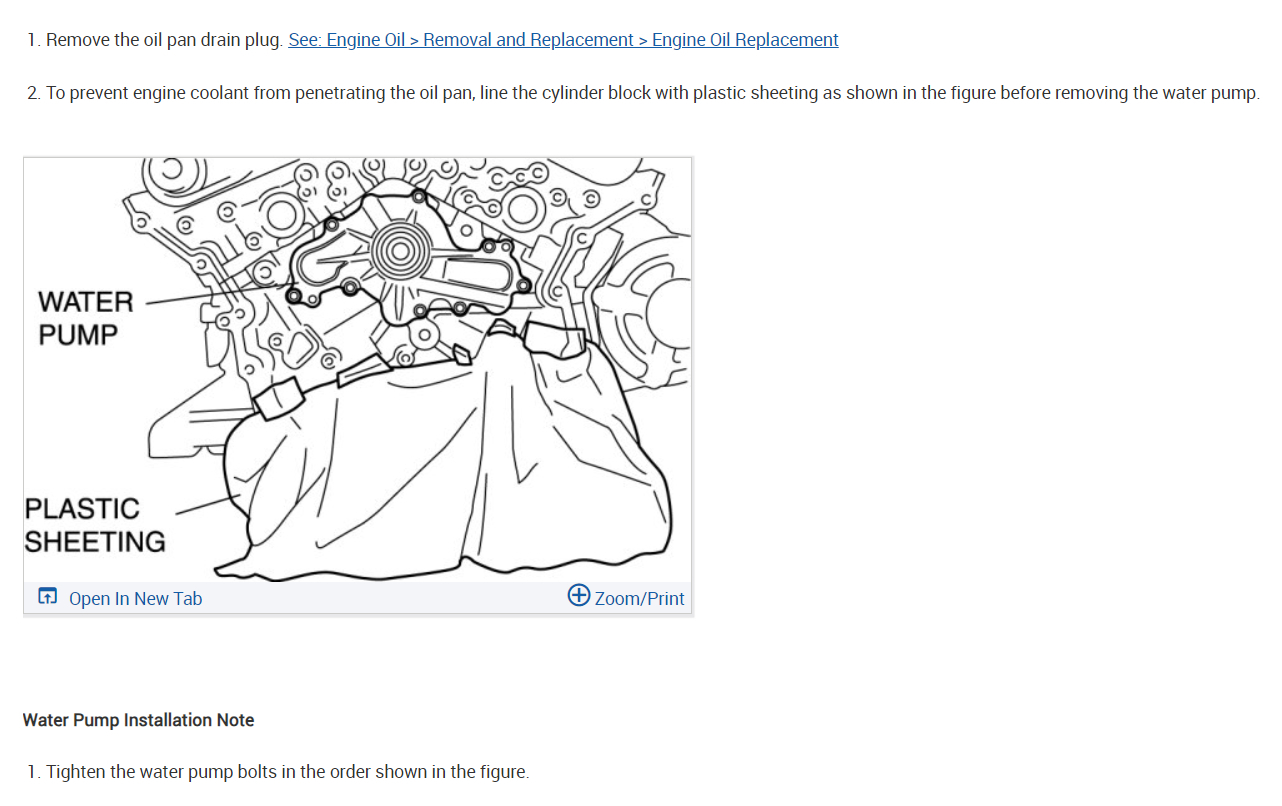

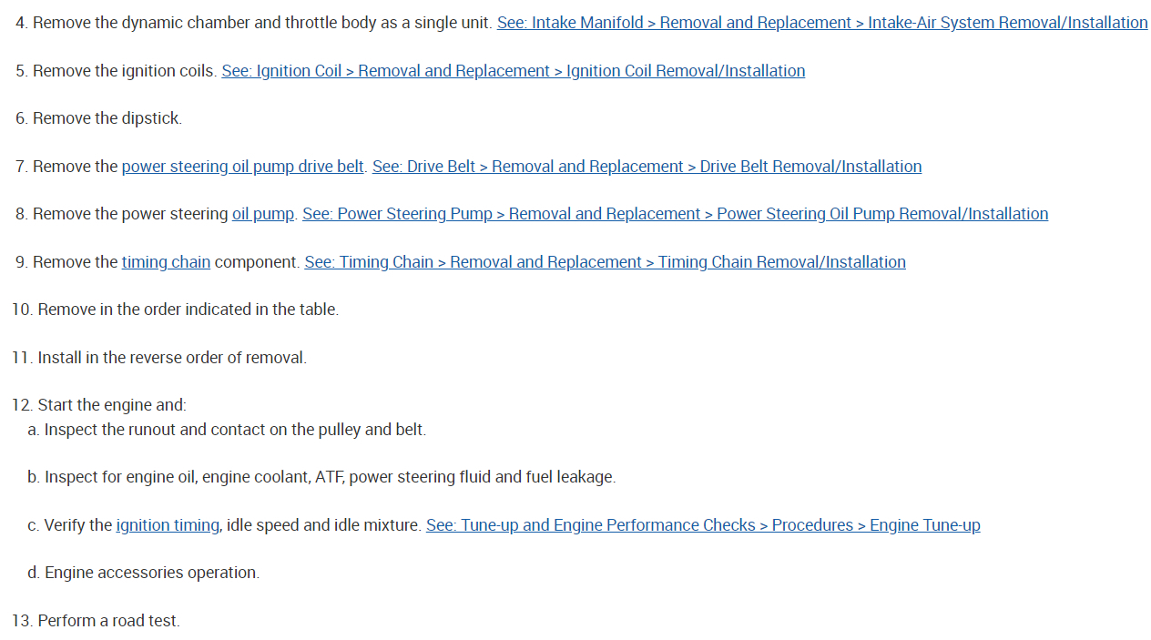

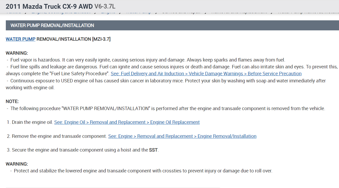

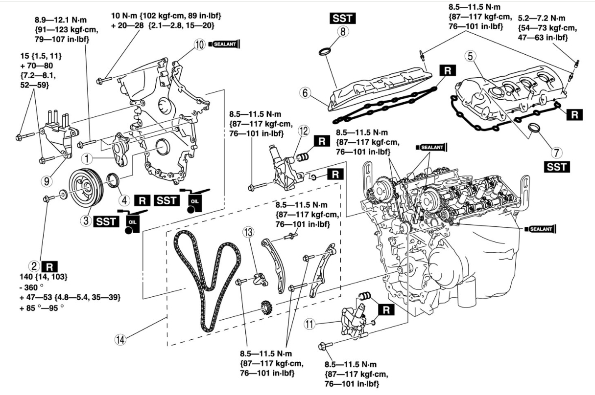

All used cars need repairs, so it will be up to you if you have had enough and want to pay for a new one or put the money into the car you already have. The water pump timing belt combo is a normal service item repair. If you have taking good care of the car, I would have the repairs done because the car can go 250k. Here is the job that needs to be done with an estimate by the book of what it should cost. Keep in mind that may be added costs such as coolant drive belts etc. The reason for the cost is the engine needs to be removed from the vehicle to do the job.
Water Pump, R&R 16.8 hours @ shop rate
The engine has a timing chain not a belt btw and this is a big job, can I ask on what makes you think you need to repairs done? Is it leaking coolant? Check out the images (below). Please upload pictures or videos of the problem so we can see what's going on.
