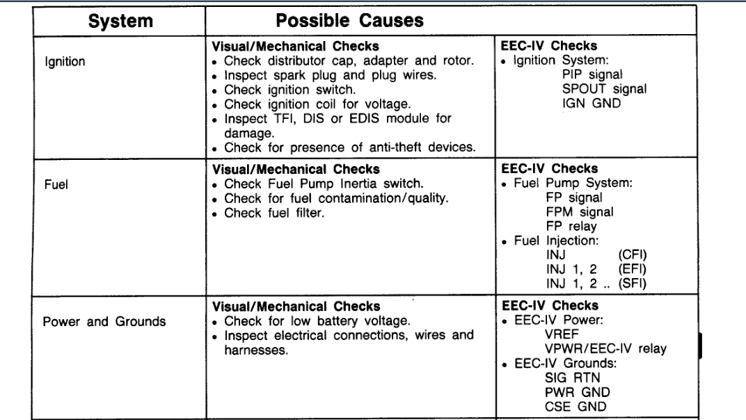

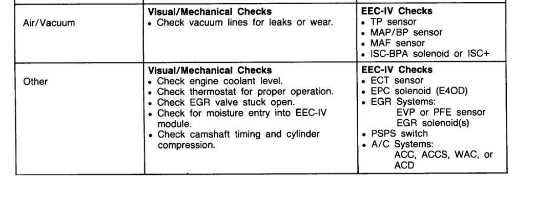

Engine will only idle for less than a couple of minutes before shutting off. I have narrowed it down to the spark ignition system shutting down. When driving it jerks and bucks violently when you try to accelerate. Driving or idling the ignition system has a dead miss on all cylinders. I have replaced the entire ignition system, checked the timing, replaced every sensor, fuel filter and the fuel pump. I’ve ran the codes and it shows 18 and 33. I’m down to inspecting the wiring harness by individual wire. What could it be?
