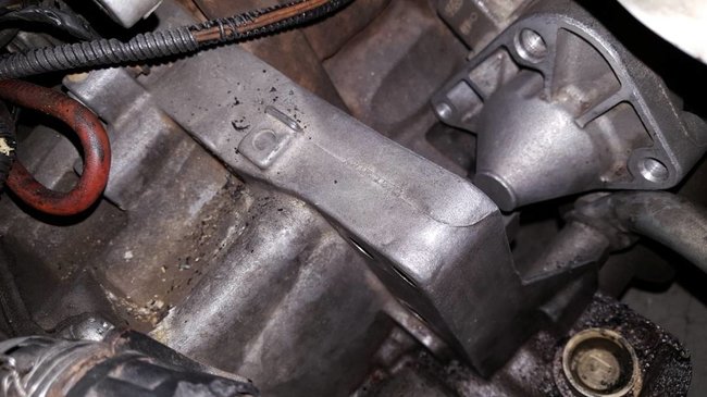

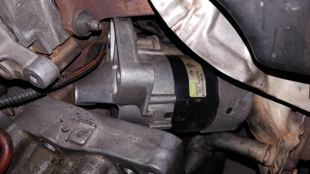

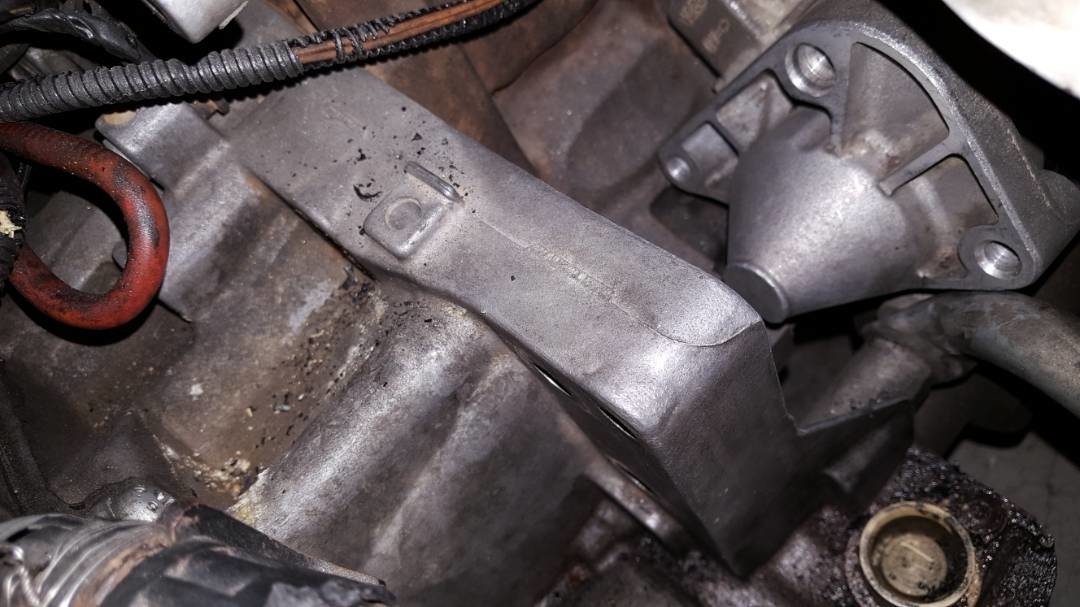

NIK KHAIRUDDIN FATHI
looks like i got to remove the exhaust manifold from underneath.
May 2, 2020 at 10:59 AM (Merged)
Yep no other way they did not make that easy at all. Thanks for the pics please upload more of the job being done if you can would be great.
