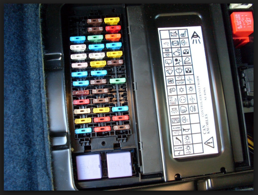

Since the other lights work for the car I would have to say the switch is bad. Try this cycle the switch many times. This will help clean the contacts and help the switch work again. Since this switch is not used very often this is common problem.
Here is a guide to help you get the fuses checked as well.
