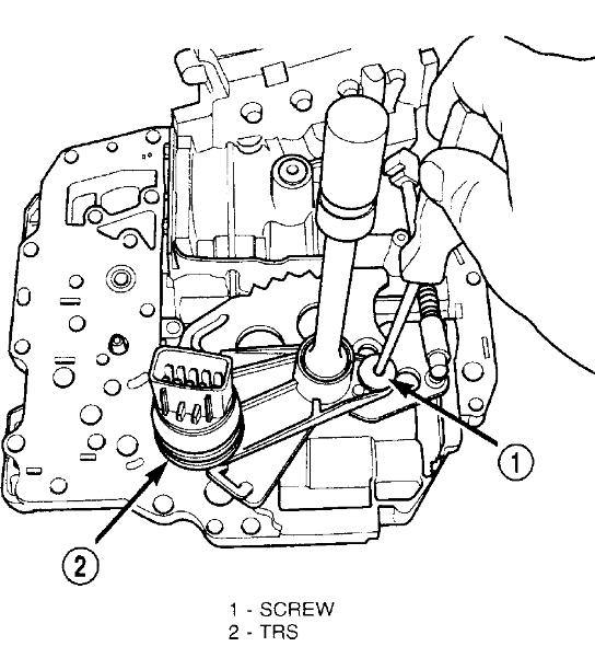

Alright, I've got the car up off the ground and the battery disconnected. Could you help me locate the Transmission Range Sensor connector that must be disconnected near the shift lever? Is it below and aft of the shift lever or below and forward of the shift lever?
Apr 16, 2013 at 1:57 PM
HMAC300
  • 48,601 POSTS
the second pic shows the trs it is item 2
Apr 16, 2013 at 3:09 PM
DTC2004
  • 11 POSTS
I've seen this picture before, but it didn't help me locate it. Is this inside the valve body or is it a part of the TCM? I'm just having a lot of difficulty locating it inside the engine bay.
Apr 16, 2013 at 5:05 PM
HMAC300
  • 48,601 POSTS
it is a part that is inside the transmission it is what you asked for.
Apr 16, 2013 at 5:09 PM
DTC2004
  • 11 POSTS
