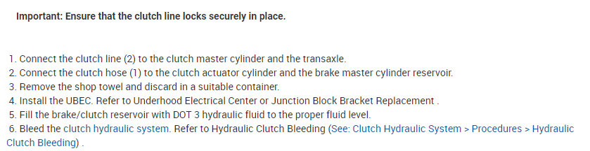

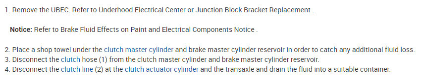

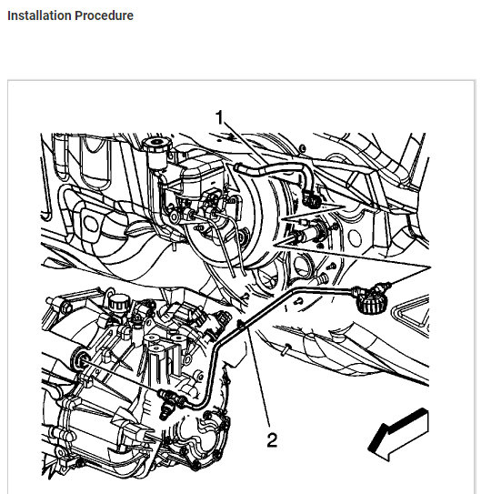

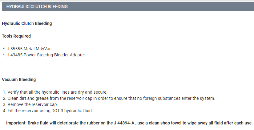

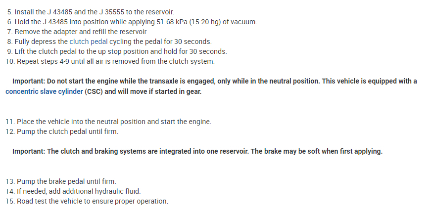

So I can get to the hydraulic line that's connected to the Master Clutch Cylinder. I asked earlier but if there was more images or videos available to show. As they say easier to show then to say. If you can provide further data on the process? Greatly appreciated, thank you.
Jun 3, 2021 at 9:00 PM
DANNY L
  • 5,648 POSTS
Hello, I'm Danny.

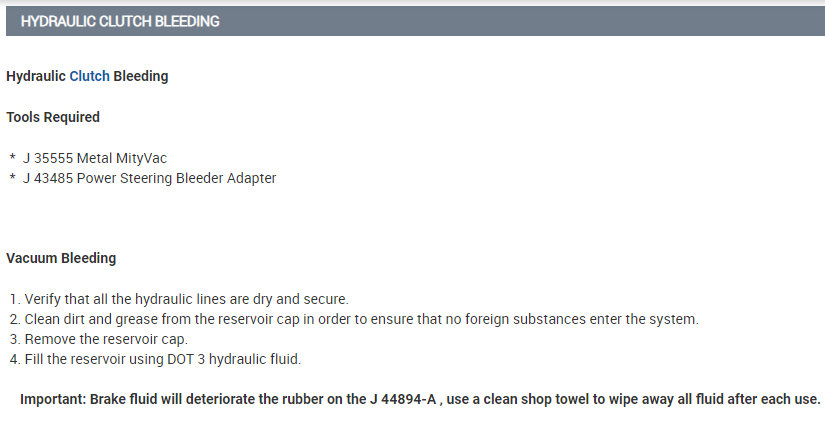

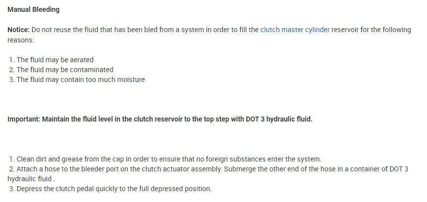

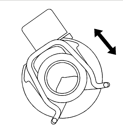

Here is what I found for you on changing the clutch slave cylinder line replacement. I've attached picture steps below for replace of the line and the clutch bleeding procedure after making the repair on your car. Hope this helps and thanks for using 2CarPros.
