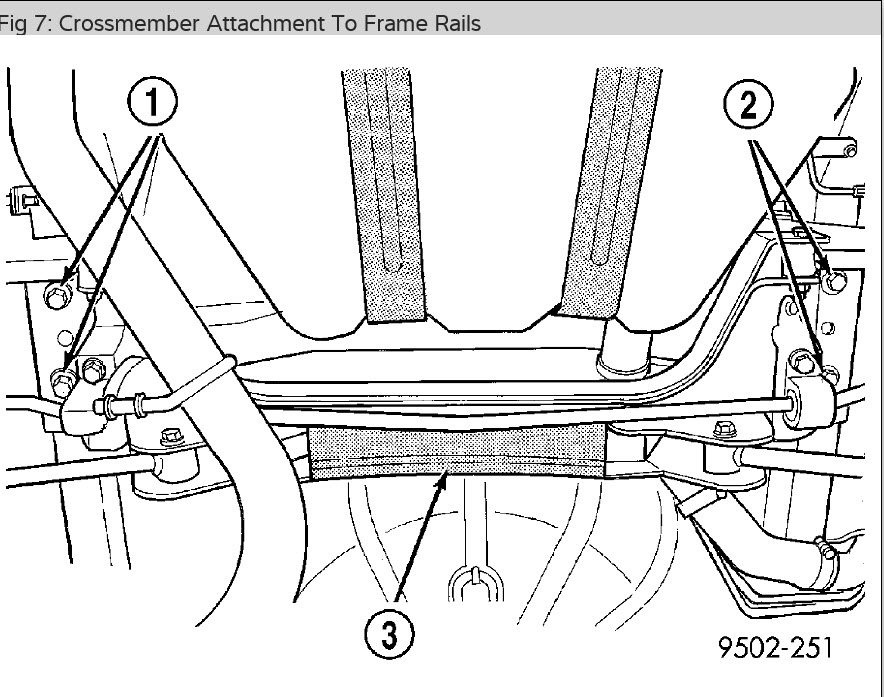

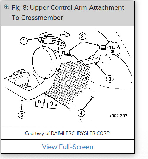

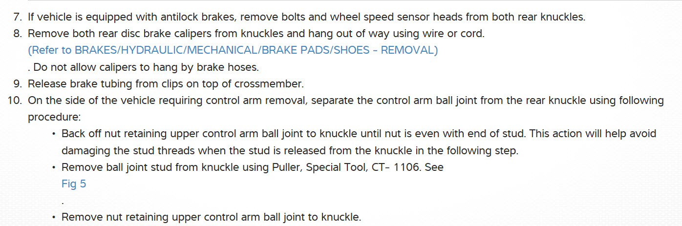

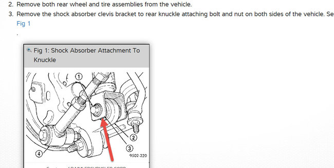

Could anyone give directions on the removal of the rear upper control arm? i removed the bolts hold it on but do i need to remove the shock or does it come out with out its removal?
Apr 30, 2017 at 12:35 PM
HMAC300
  • 48,601 POSTS

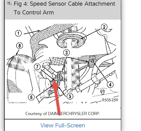

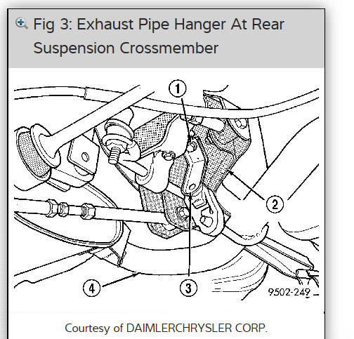

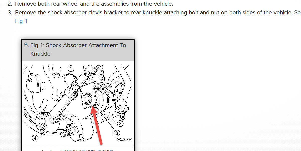

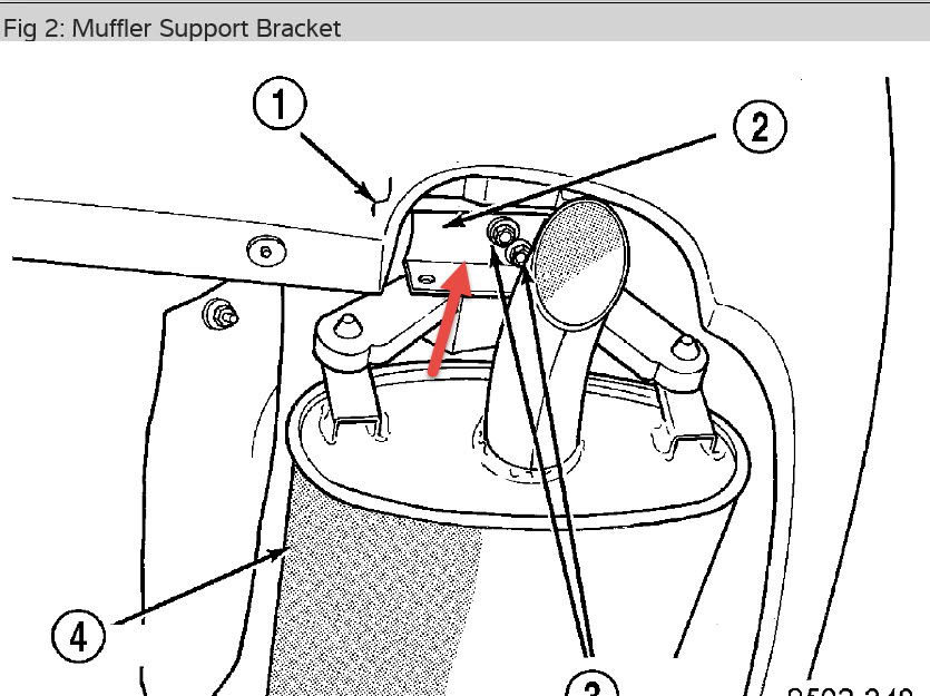

see pictures for instructions, but you need to practically drop the axle in order to remove it.
