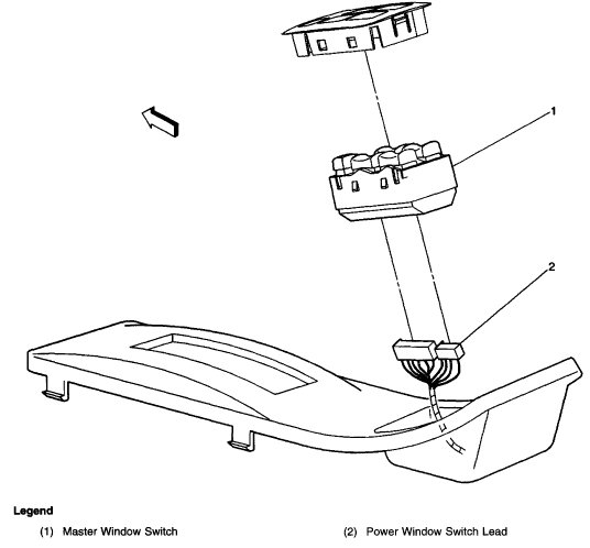

Hi and thanks for using 2CarPros.com. Basically, you are doing it correctly. Here are the specific directions for you vehicle. Just be careful.
Removal proceedure:
Use a flat-bladed screwdriver in order to pry the power window switch outward.
Disconnect the power window switch wire harness.
Remove the power window switch.
Installation proceedure:
Connect the power window switch wire harness.
Install the power window switch. Ensure the unit is retained.
I have attached a picture of the assembly so you can see what you are taking apart. Hopefully, it will put you at ease once you see it.
I hope this helps. Let me know if you have other questions.
