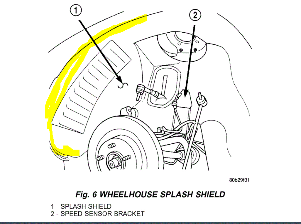

If I recall, there are plastic push pins and maybe one screw along the fender. Remove enough of them to access the battery. See pic 1. I highlighted where I believe the push pins to be located.

5. Remove battery splash shield. Refer to the Body section of the service for the procedure.
