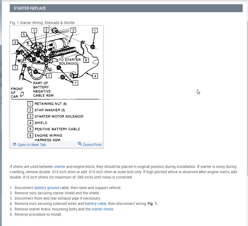

I am just having difficulty on how I should go about removing the starter to my car. it is in a very tight area and I'm wondering if there's an easier way to get to it instead of removing the exhaust from the engine.

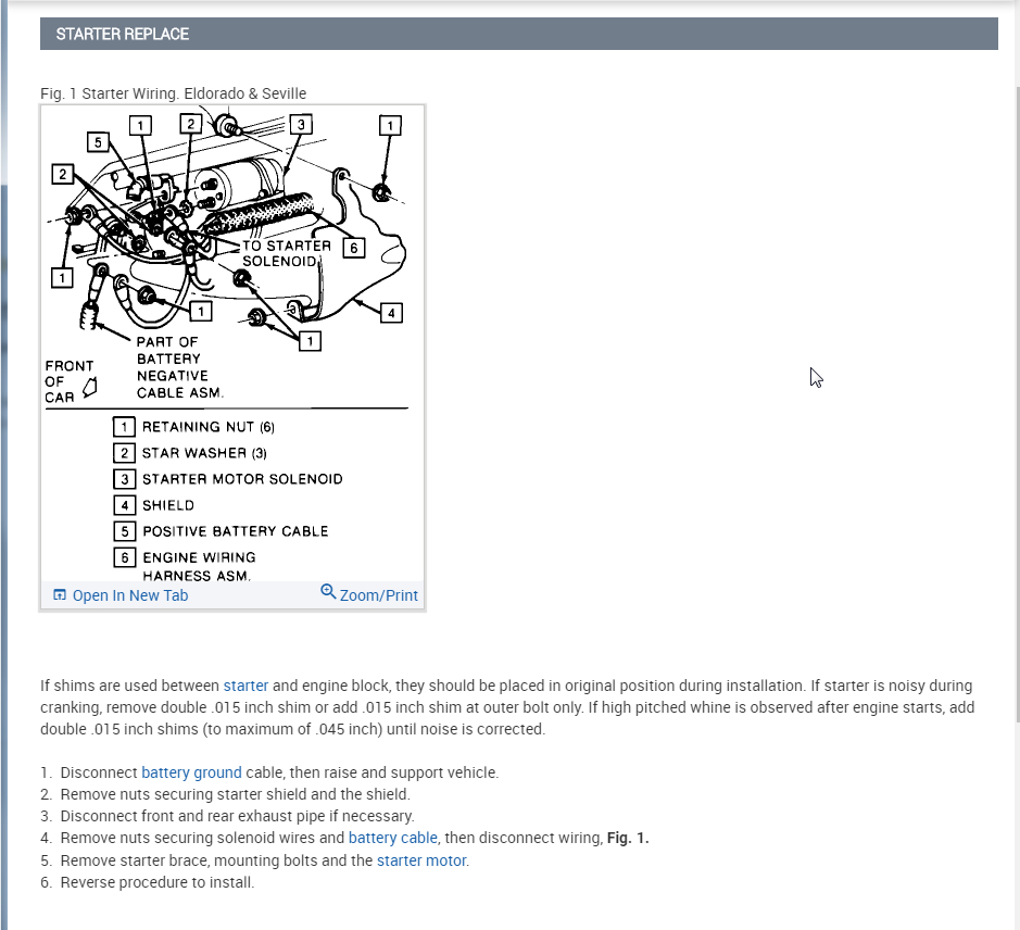

I attached the service manual info. They are not very detailed but they do mention removing the front and rear exhaust pipes which will give room. I looked online for short cuts because I have not done a starter on this vehicle but did not find anything. So unless you see an easier way when looking at, I suspect the exhaust needs to come out.
This guide can help walk you through the steps:
Sorry I didn't have a better answer for you. Let us know if you find a better way then what is laid out here. Thanks

No you are fine. I kind of figured the exhaust needed to come out, it was worth a try. Thanks!

Sorry. Yeah. It never hurts to ask but short cuts are normally pretty obvious on these types of repairs. Let us know if you need anything else and we can help out. Thanks
