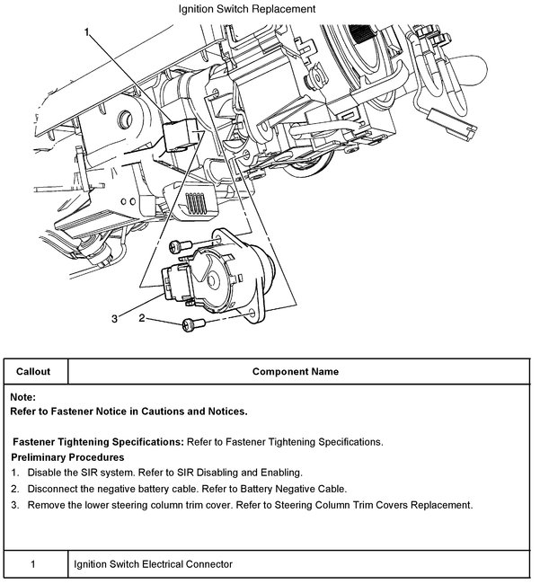

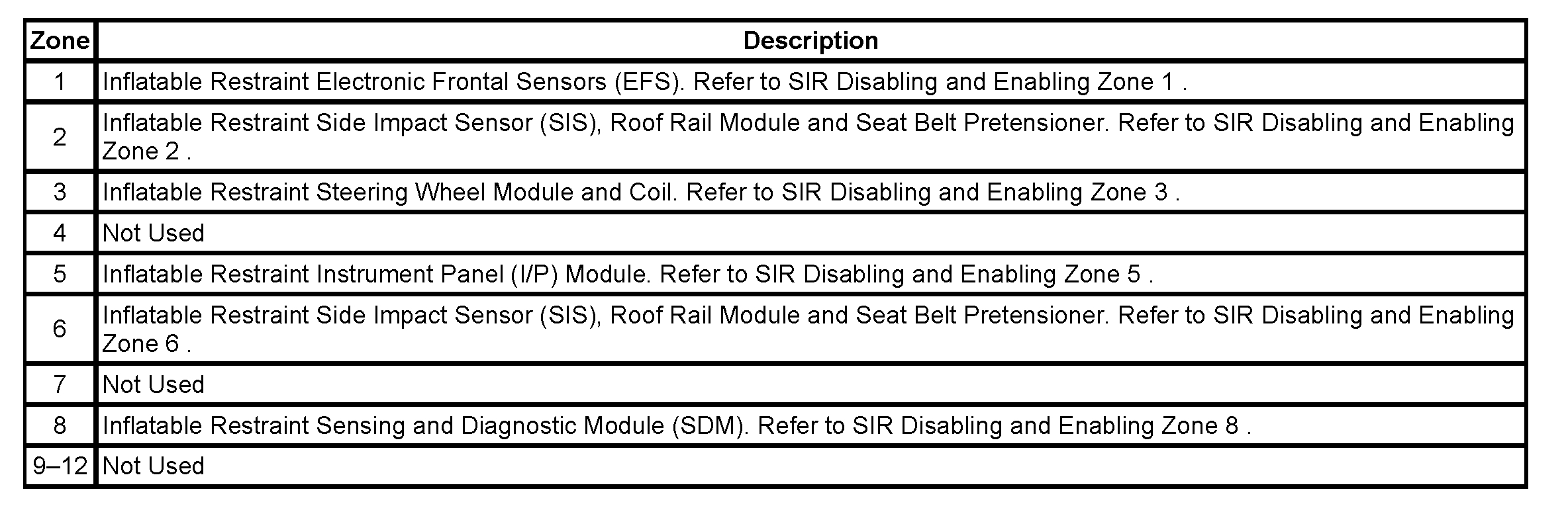

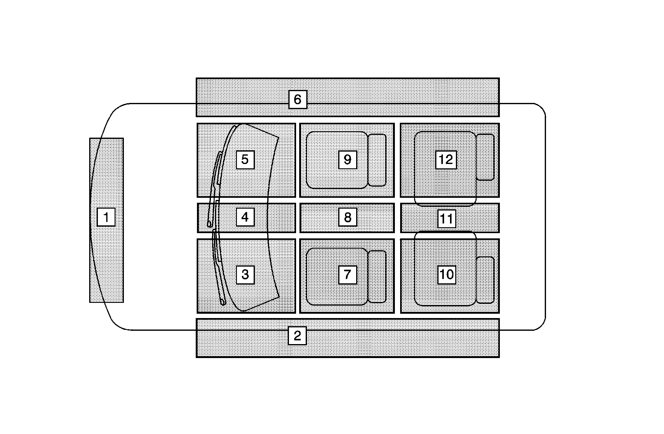

You are correct. Zone 3 needs turned off/disabled when doing the repair. Here are the directions for disabling zone 3 (steering wheel). Picture 1 shows zones, picture 2 zone locations,
SIR DISABLING AND ENABLING ZONE 3

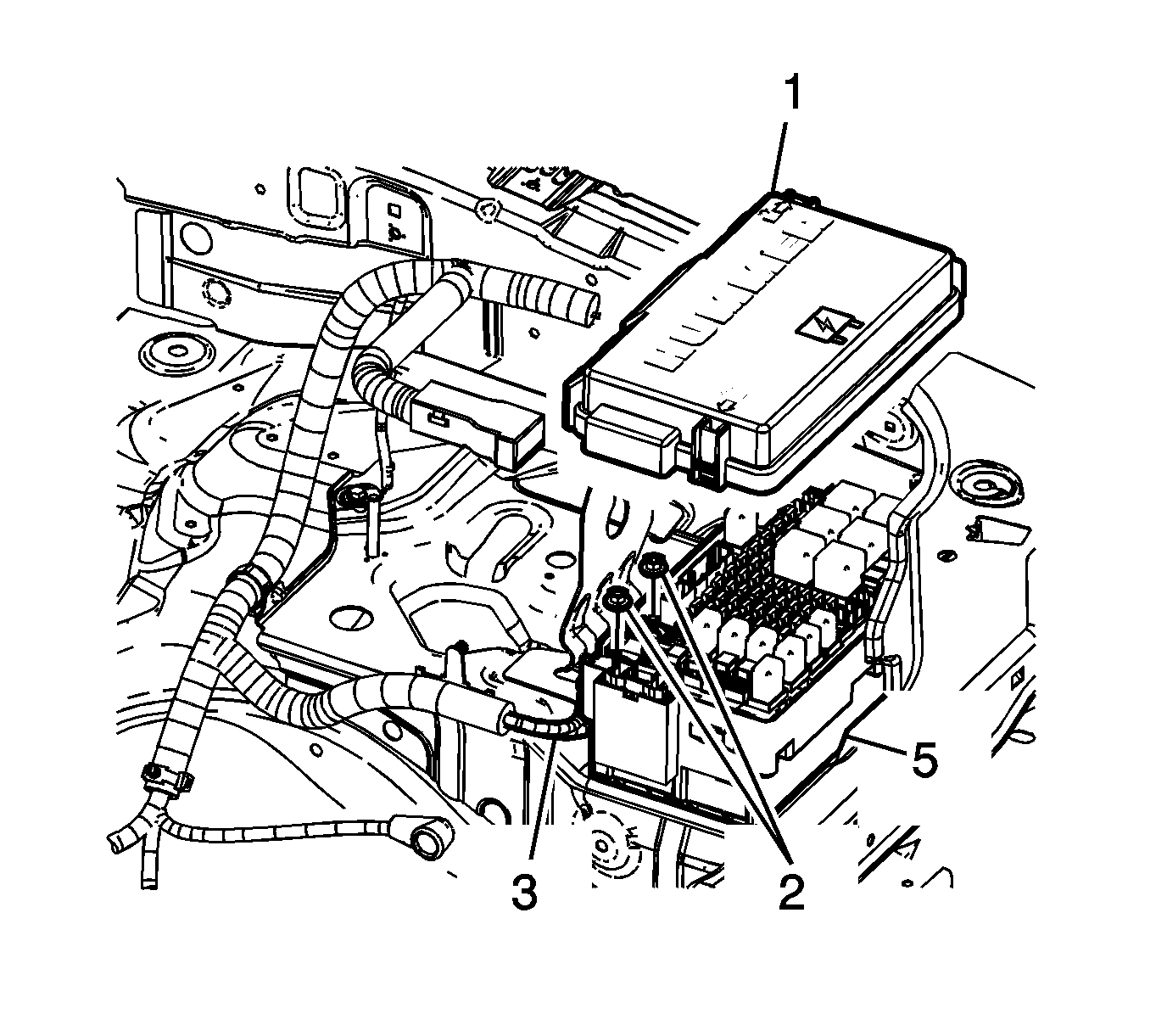

(pic 3)
5. Remove the Air Bags fuse from the fuse block (5) located in the underhood fuse block.
IMPORTANT: With the Air Bags fuse removed and the ignition ON, the AIR BAG indicator illuminates. This is normal operation and does not indicate an SIR system malfunction.

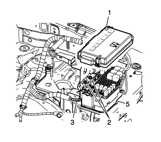

(pic 4)
6. Remove the connector position assurance (CPA) (1) from the steering wheel module yellow 4-way connector (2) located left of the steering column above the left hinge pillar trim panel.
7. Disconnect the steering wheel module yellow 4-way connector (2) located left of the steering column above the left hinge pillar trim panel.

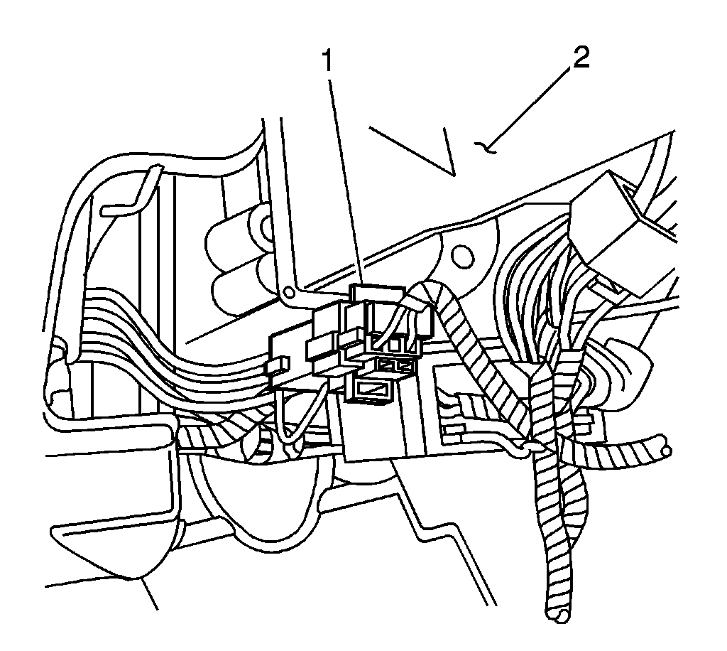

(pic 5)
2. Connect the steering wheel module yellow 4-way connector (2) located left of the steering column above the left hinge pillar trim panel.
3. Install the CPA (1) to the steering wheel module yellow 4-way connector (2) located left of the steering column above the left hinge pillar trim panel.

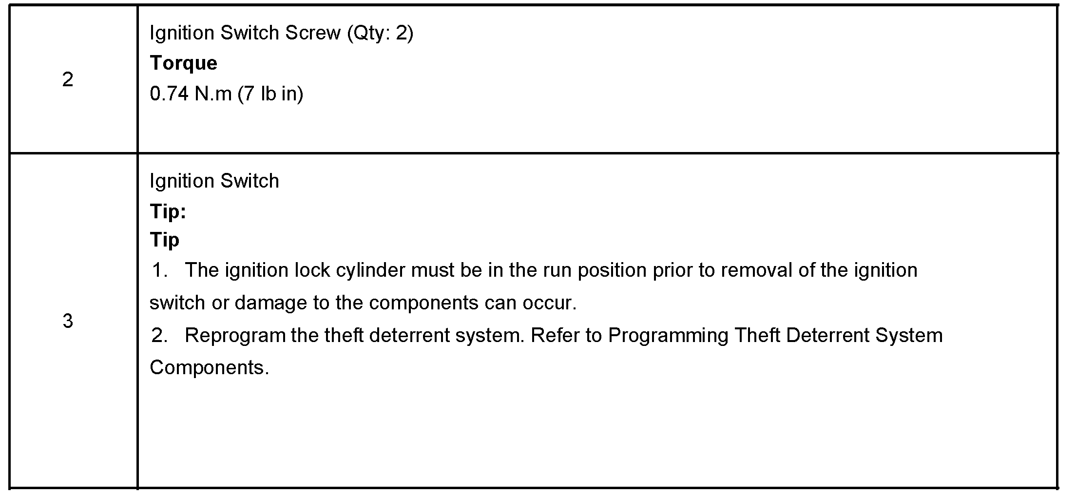

(pic 6)
4. Install the Air Bags fuse to the fuse block (5) located in the underhood fuse block.
5. Staying well away from all air bags, turn ON the ignition, with the engine OFF.

Now for the switch directions. In my manual, they are shown in picture form. Therefore, I have attached the directions in pictures 7 and 8. If you are unable to read them, let me know and I'll help you through them.
Note that step 2 says to disconnect the battery.
Last, the new switch will need relearned. There are two ways of doing it. One way is using a tech 2 scanner. The second doesn't require a scanner, but you must follow the directions.
