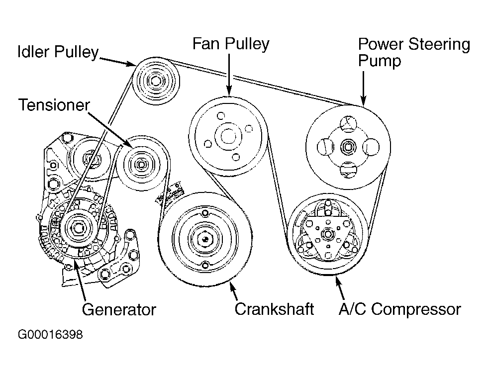

here is a diagram of the serpentine belt, make sure you disconnect the negative battery cable first, use the tensioner pulley to remove the belt and reinstall it. Then you can remove and reinstall the new alternator.
