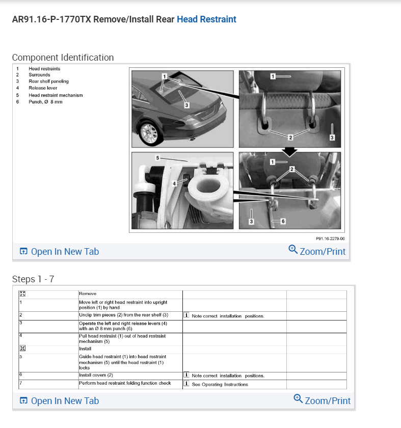

Trying to remove the back tray around the headrests but i need to remove the headrests first. I pulled the back seats out and just now looking for some lever to release the headrests.
Aug 11, 2022 at 8:24 AM

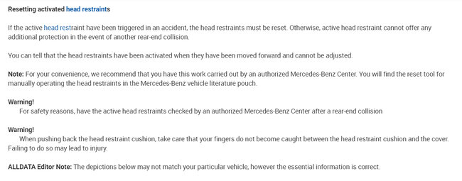

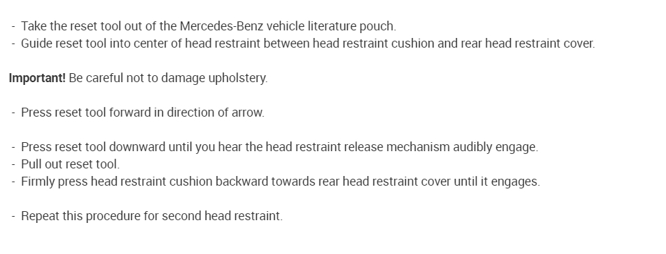

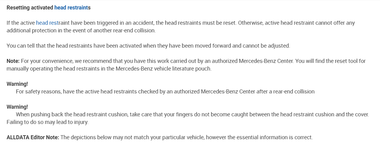

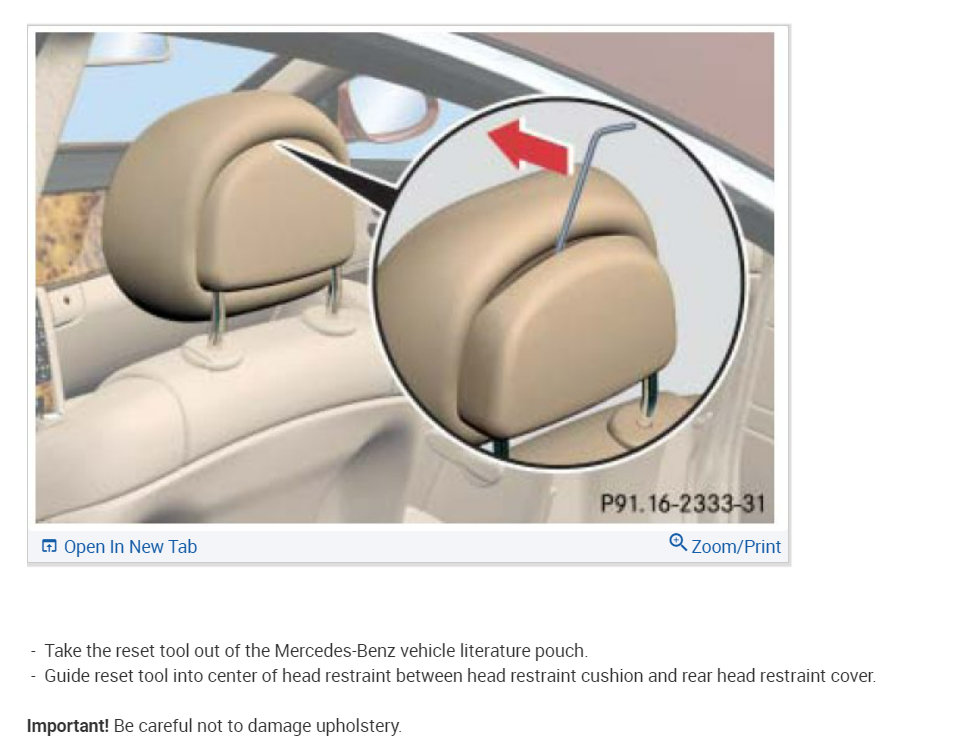

Here is what I found to remove the headrests in the images below. Check out the diagrams (below). Please let us know if you need anything else to get the problem fixed.
