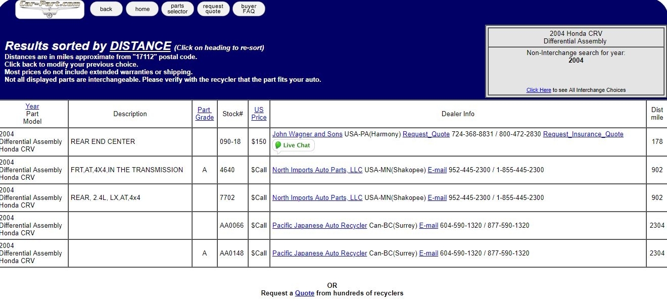

The differential noise is worn bearings. It would be easier to replace the unit with a used unit and return it to original condition. It would also be cheaper than trying to convert it.
Check the results for the differentials. It is on a site I used all the time. WWW.car-part.com.
