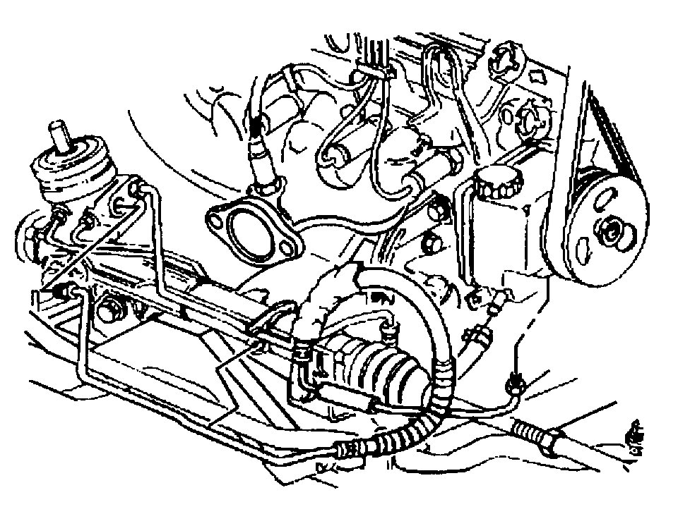

pic 1
5. Remove the power steering pressure line from the power steering pump. Refer to Power Steering Pressure Hose Replacement (3.8 L) or Power Steering Pressure Hose Replacement (3.4 L)
6. Remove the power steering return hose from the power steering pump. Refer to Power Steering Return Hose Replacement (3.4 L) or Power Steering Return Hose Replacement (3.8 L)

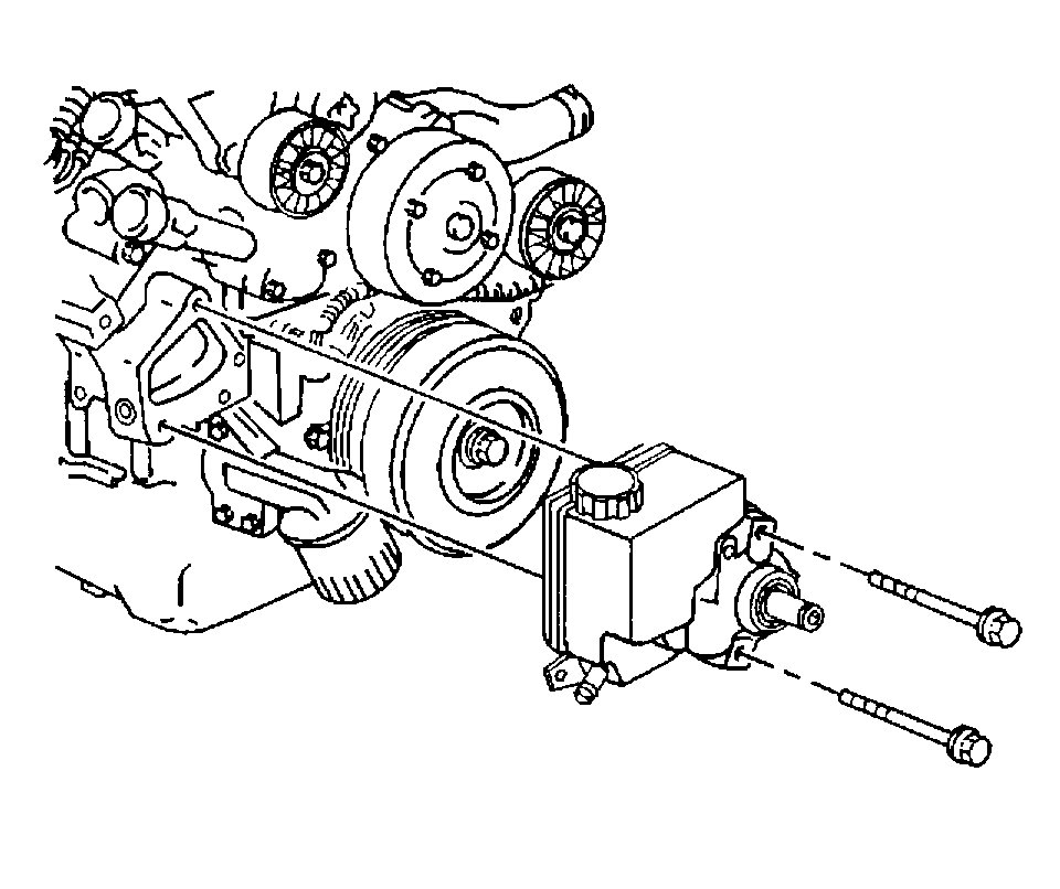

pic 2
7. Remove the power steering pump mounting bolts from the power steering pump.
8. Remove the power steering pump assembly.
9. Remove the power steering pump pulley from the power steering pump. Refer to Power Steering Pulley Replacement.
10. Remove the power steering pump reservoir from the power steering pump. Refer to Power Steering Reservoir Replacement - Off Vehicle (CB Series).
