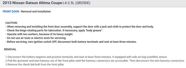

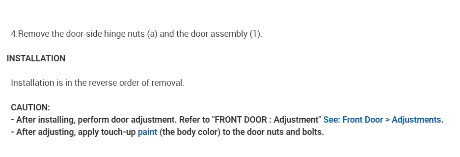

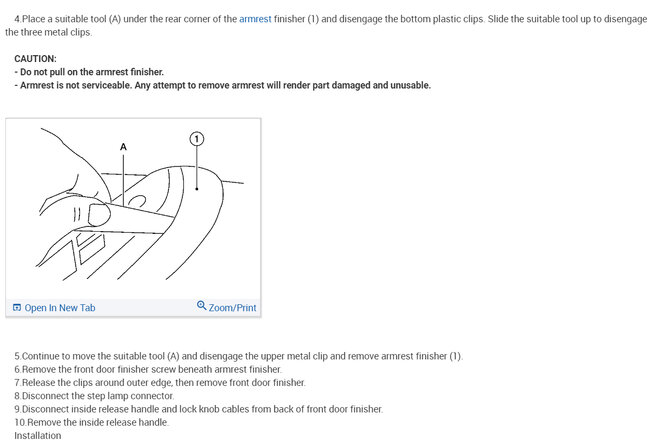

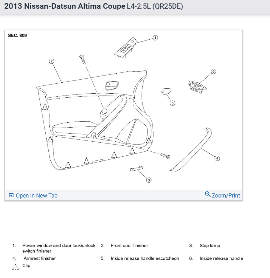

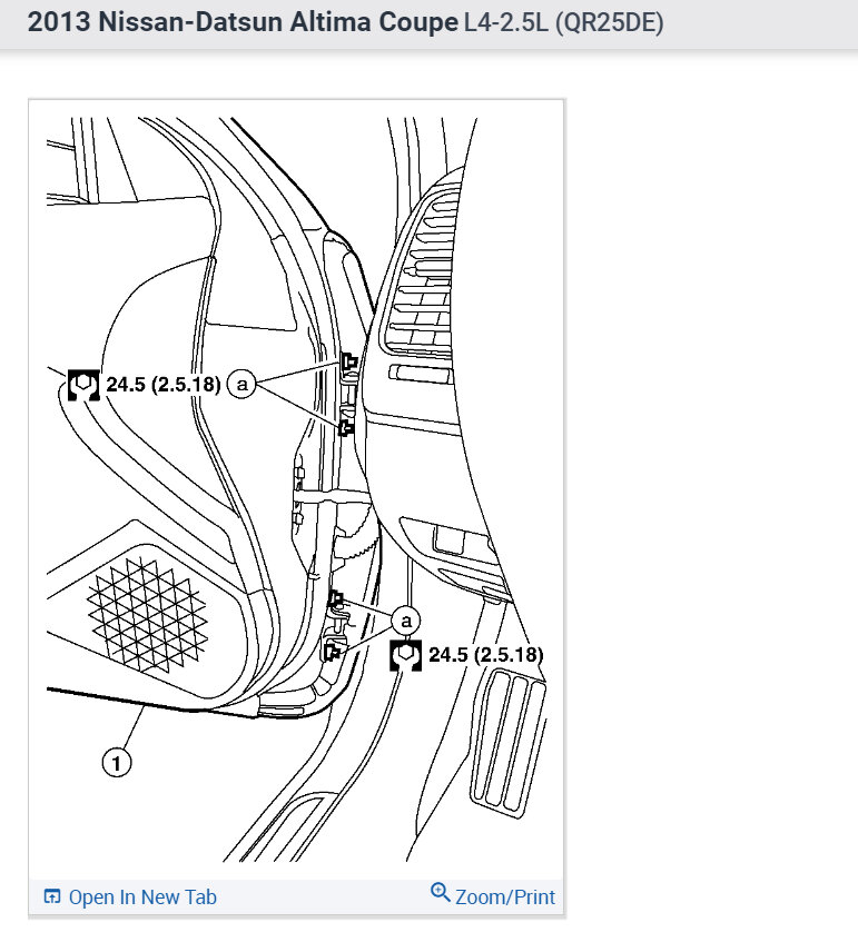

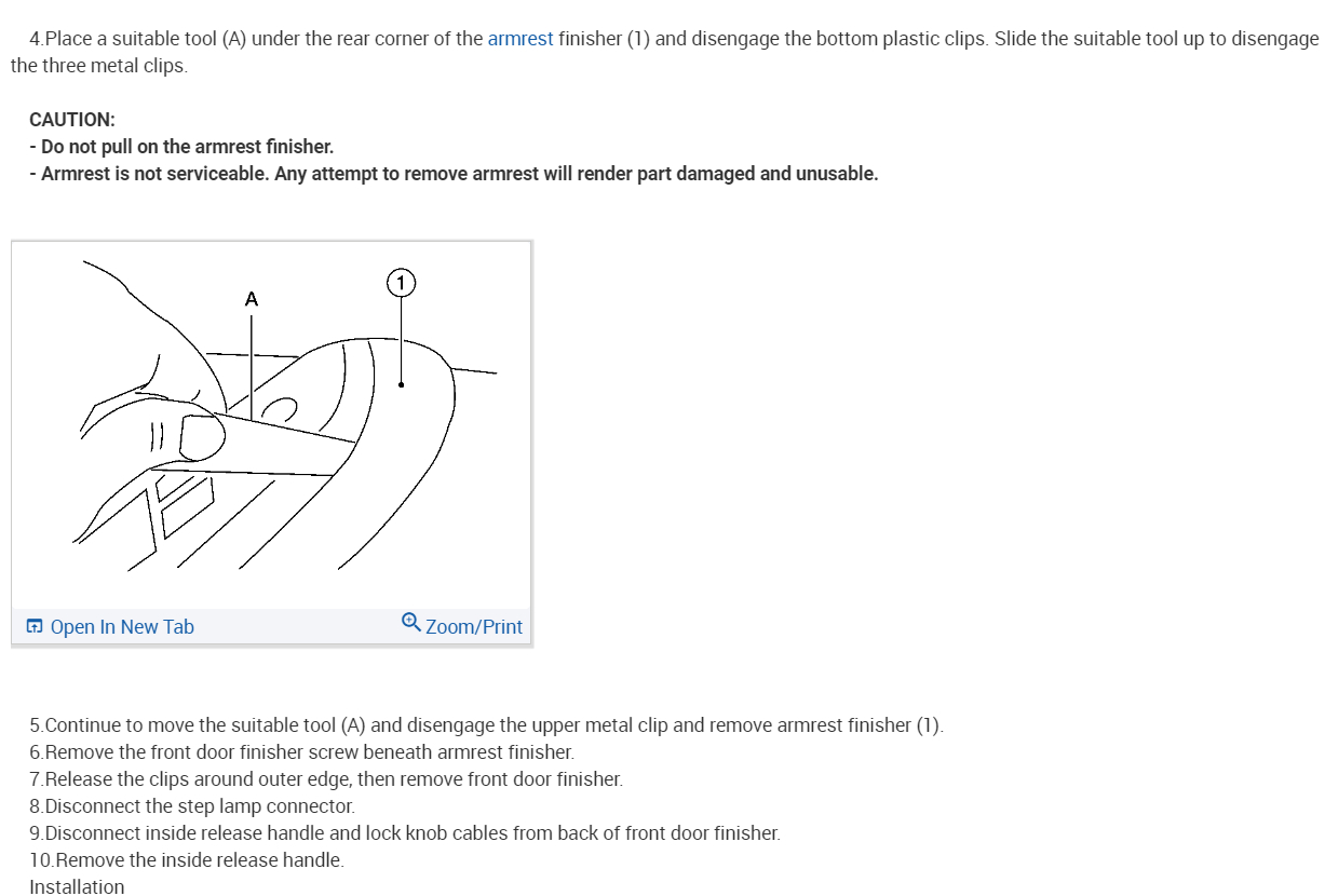

How can I replace my passenger door and what tools will I need to get the job done?
Jun 15, 2023 at 6:53 PM

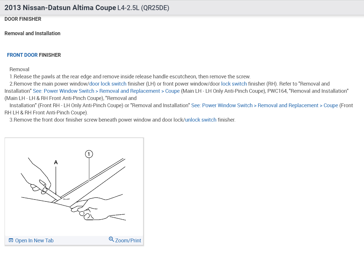

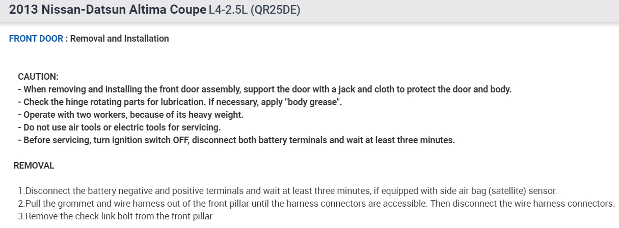

You will need a wrench and ratchet set. Here are the instructions on how to replace the door which included removing the door panel and disconnecting the wiring from the inner door accessories. Check out the images (below). Please let us know if you need anything else to get the problem fixed.
