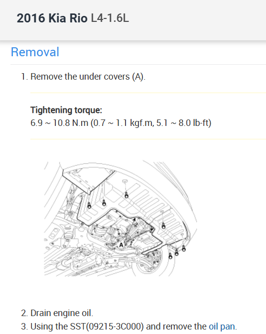

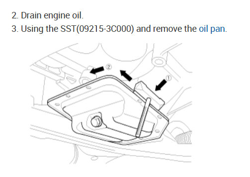

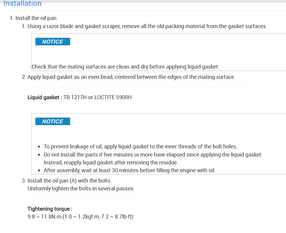

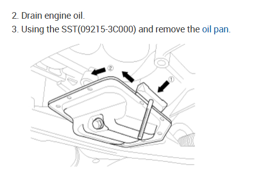

Yep, first you must remove the under shield and then drain the engine oil, here are the instructions on how to change the oil pan gasket out. Check out the images (below). Let us know if you need anything else.
