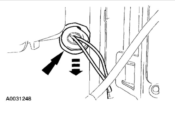

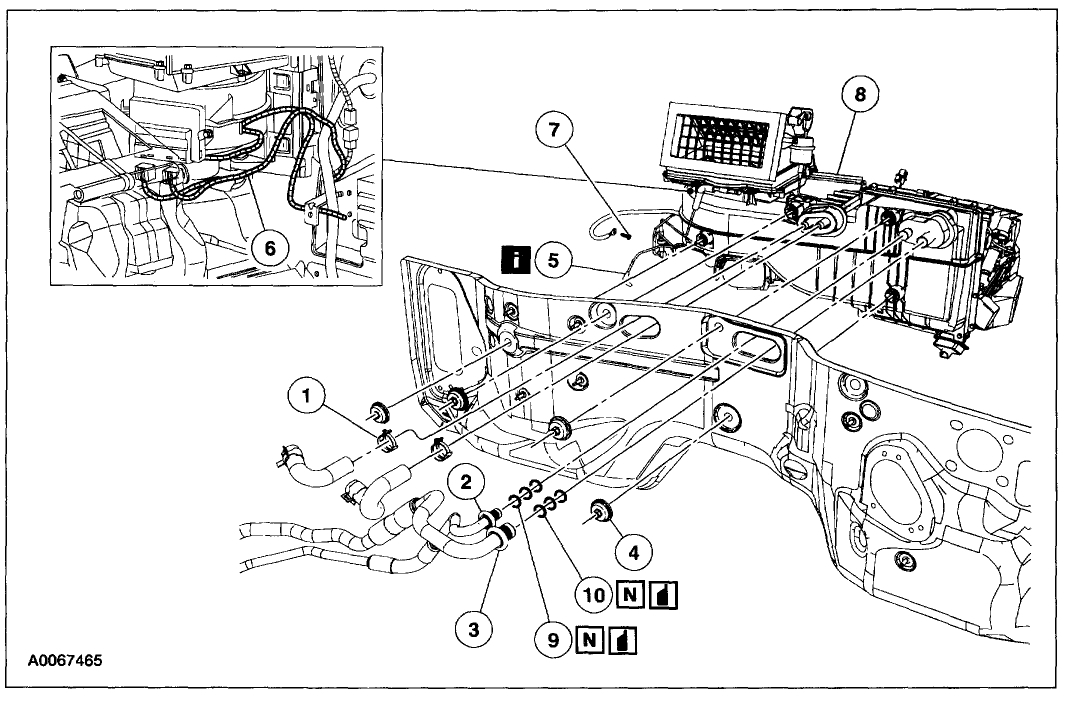

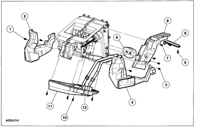

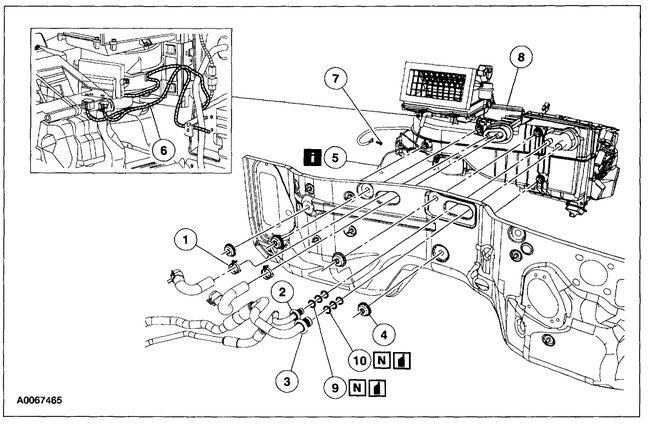

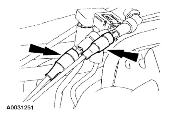

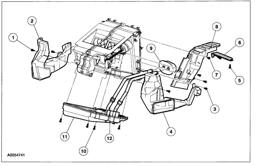

Here is a generic guide to help you step by step with instructions in the diagrams below to show you how on your car.
https://www.2carpros.com/articles/replace-heater-core

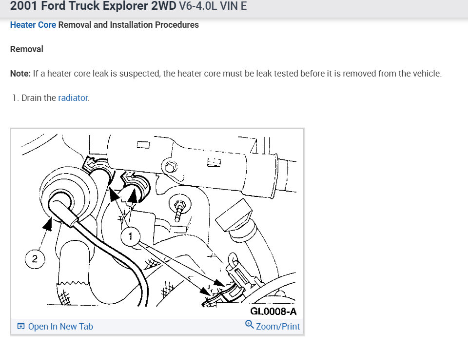

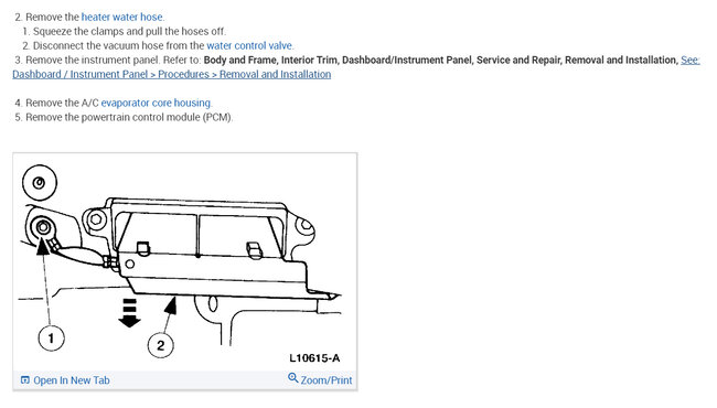

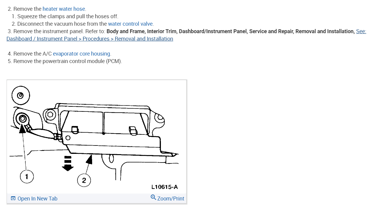

Heater Core Removal and Installation Procedure
Please check out the images below.
Removal
Note: If a heater core leak is suspected, the heater core must be leak tested before it is removed from the vehicle.
Drain the radiator.
Remove the heater water hose.
Squeeze the clamps and pull the hoses off.
Disconnect the vacuum hose from the water control valve.
Remove the instrument panel. Refer to: Body and Frame, Interior Trim, Dashboard/Instrument Panel, Service and Repair, Removal and Installation, See: Body and FrameInterior Moulding / TrimDashboard / Instrument PanelService and Repair
Remove the A/C evaporator core housing.

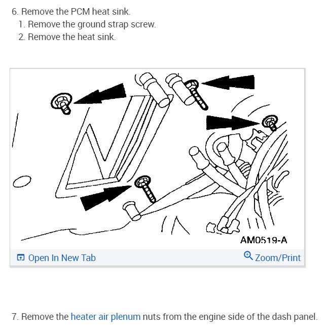

Remove the powertrain control module (PCM).
Remove the PCM heat sink.
Remove the ground strap screw.
Remove the heat sink.

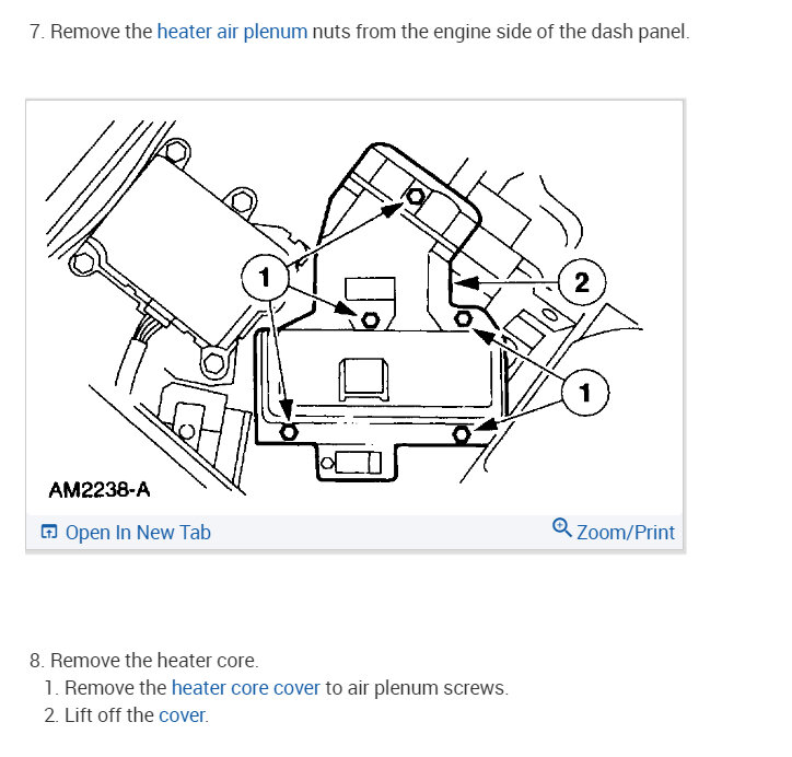

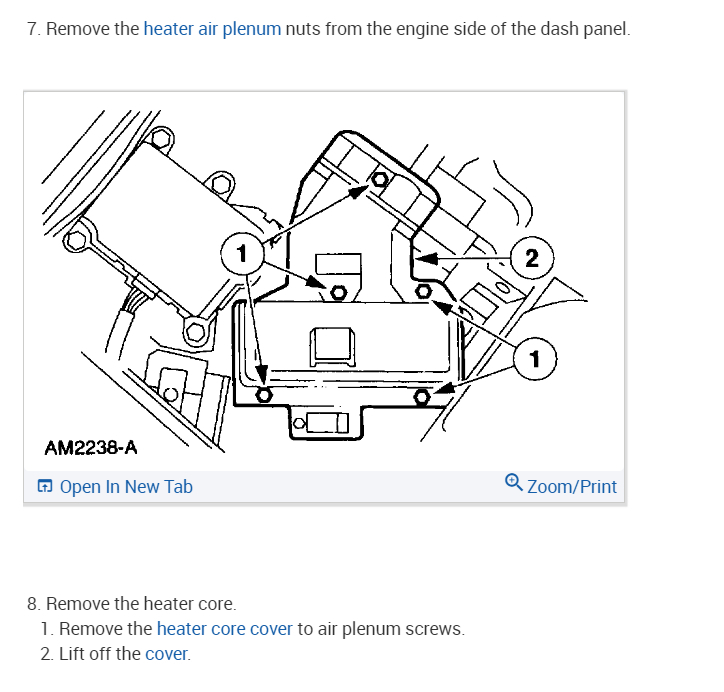

Remove the heater air plenum nuts from the engine side of the dash panel.

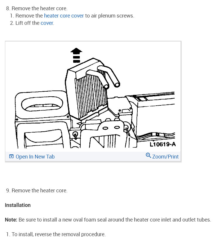

Remove the heater core.
Remove the heater core cover to air plenum screws.
Lift off the cover.
Installation
Note: Be sure to install a new oval foam seal around the heater core inlet and outlet tubes.
To install, reverse the removal procedure.
Check out the images (below). Let us know how it goes
