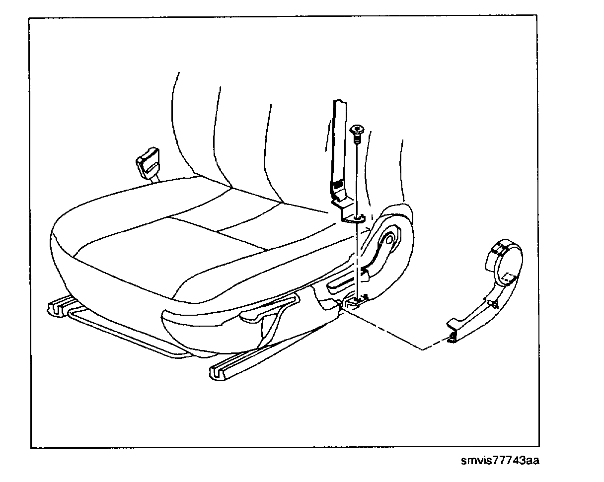

It sounds like the cage nut is turning. It is actually spot welded from the factory. I have two options. First, if you only need to repair the seat itself, it can be removed without the track which is bolted to the floor. Here are the directions for that. The attached pictures correlate with the directions.
SEAT REMOVAL
picture 1
1. Remove front seat shoulder belt outer cover.
2. Remove shoulder belt from seat frame.

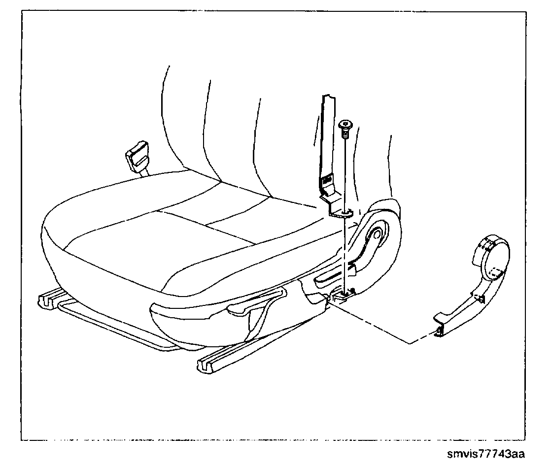

picture 2
3. Move seat to full forward position and remove front seat fasteners.
4. Pull seat assembly slightly rearward to disengage seat from front set track books.
5. Tilt seat rearward and disconnect seat wiring harnesses.
6. Remove seat from vehicle and place on clean protected work surface.

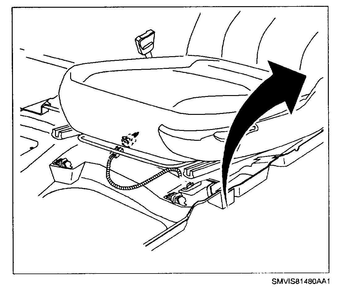

INSTALLATION
picture 3
1. Position seat into vehicle.
2. Tilt seat rearward and connect seat wiring harnesses.
3. Slide seat into forward tracks.
4. Apply Loctite(R) 242 Threadlocker (or equivalent) to seat fasteners and install seat fasteners.
Torque:
Seat Fasteners: 25 N.m (19 ft-lbs)

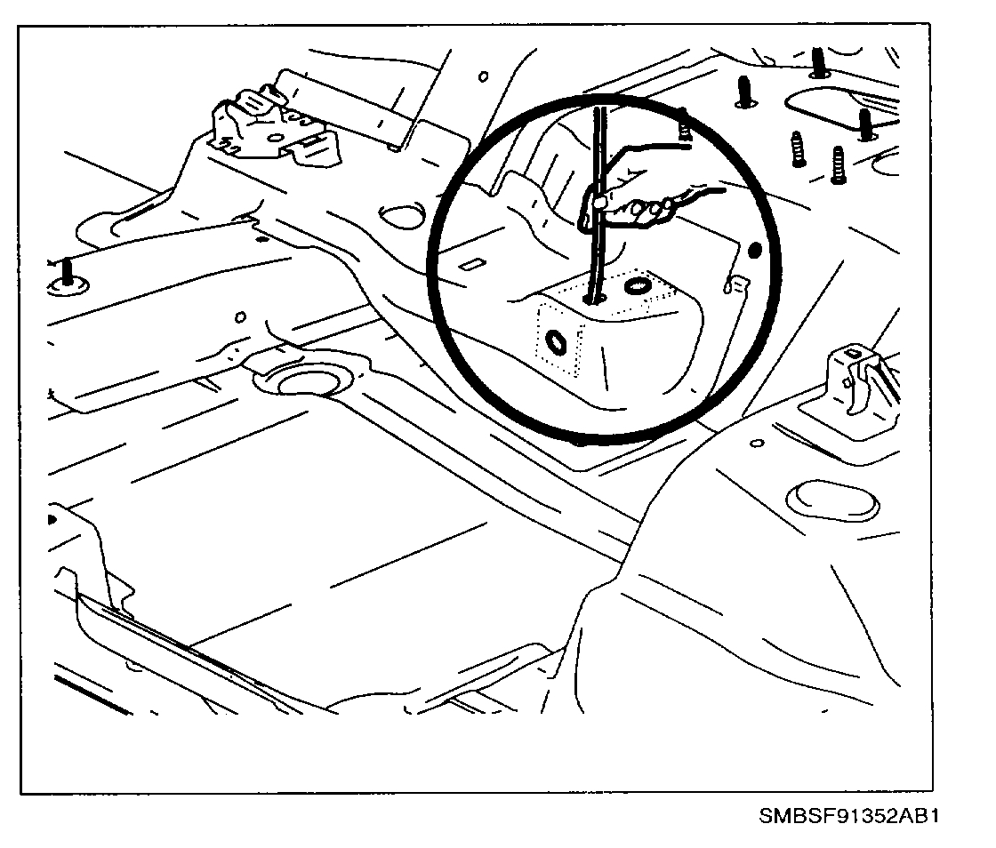

picture 4
5. Install shoulder belt to seat frame.
Torque:
Shoulder Belt-to-Seat Frame Bolt: 20 N.m (15 ft-lbs)
6. Install shoulder belt outer cover.
7. If equipped, function electrical seat components to ensure proper operation.

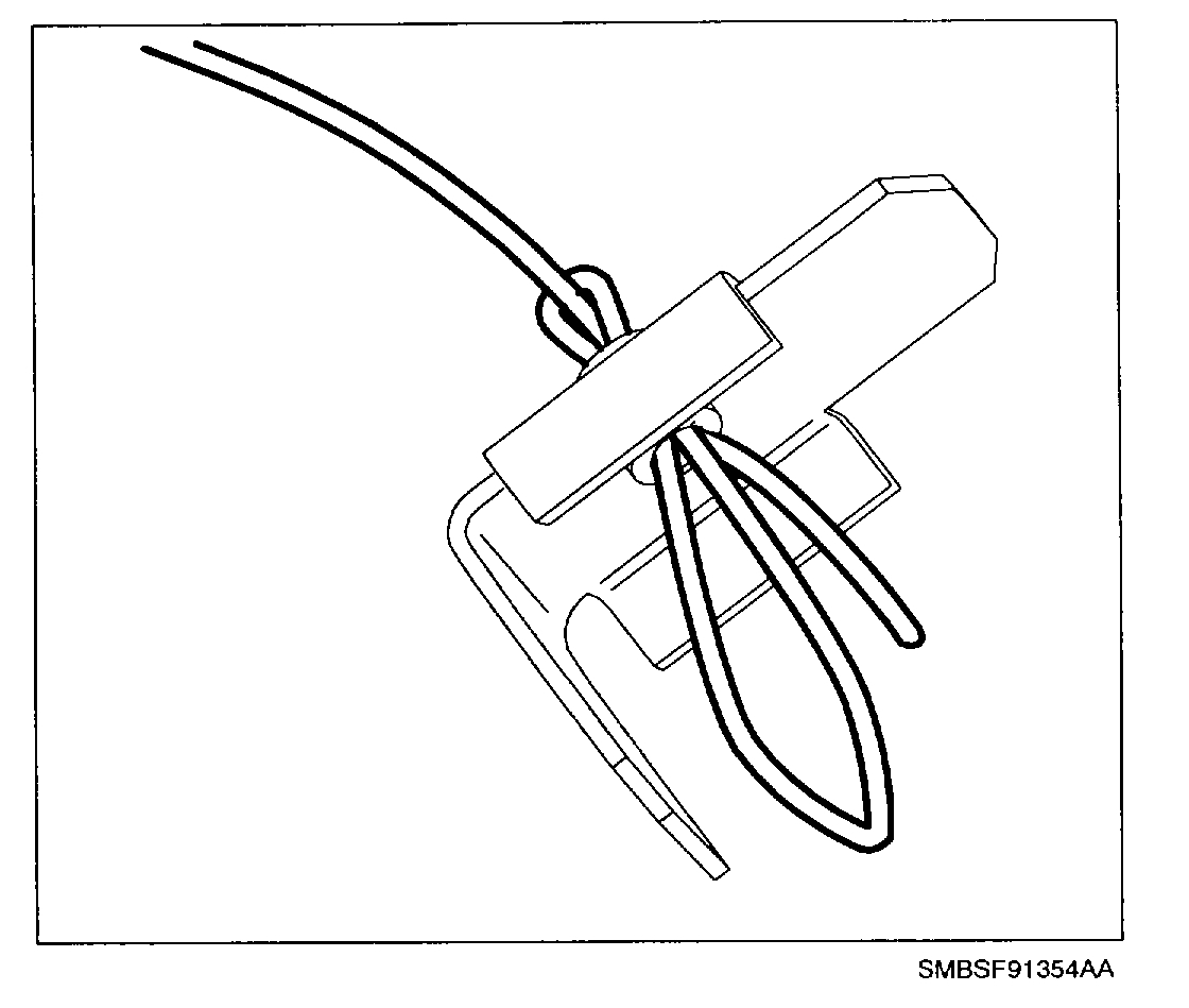

INSTALLATION
picture 5
1. Route the wire through the new cage nut so that the looped end of the wire is below the bottom surface of the cage nut.
