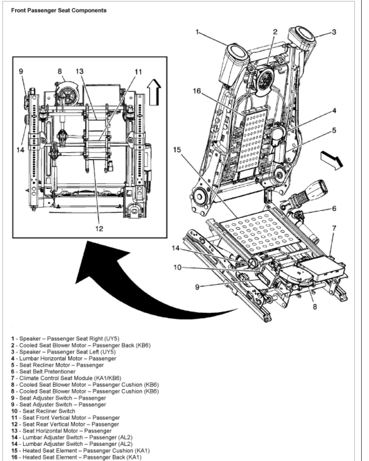

Here are the directions for the removal and replacement of the front seats. The attached pictures correlate with the directions.

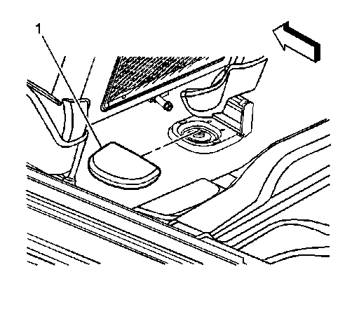

pic 1
2. Move the front seat forward in order to access the front seat track trim cover (1).
3. Remove the seat track trim cover (1) from the seat track.

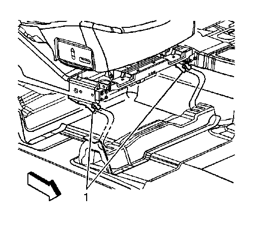

pic 2
4. Remove the seat track fasteners from the seat track.

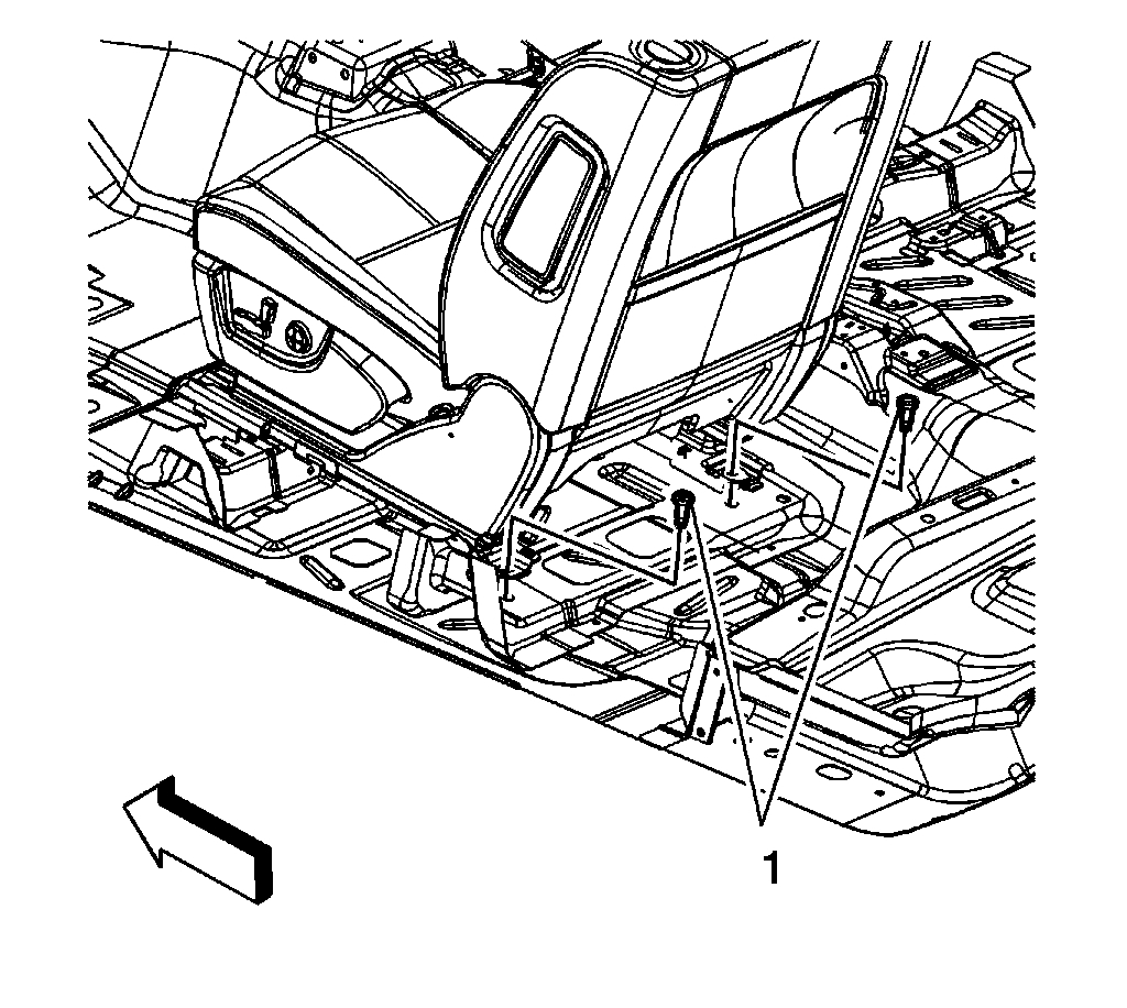

pic 3

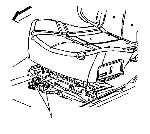

5. Disconnect the seat electrical connectors (1).
6. With the aid of an assistant, remove the seat from the vehicle.
