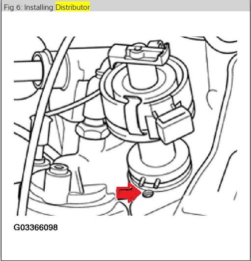

"PRODEMAND" SHOWS PUTTING THE ENGINE TO "TDC"/ MARKING THE POSITION OF THE ROTOR BUTTON. THEN REMOVING THE DISTRIBUTOR.
THE NEXT DIAGRAM SHOWN IS "INSTALLING THE DISTRIBUTOR"
THIS DIAGRAM SHOW LINING UP 2 PINS
(MY TAKE ON THIS WOULD BE TO LINE THEM UP UPON REMOVAL TOO/ BUT THAT'S JUST ME)
MAYBE IT'S JUST THE O-RING BEING BONDED TO THE METAL, WD-40/ PENETRATING OIL/ ETC MIGHT HELP BREAK IT LOOSE. A STICK OF WOOD (MOP HANDLE/ ETC) OR THE GENTLE USE OF A PRY/ CROW BAR UNDER THE TOP END OF THE DISTRIBUTOR (WORKING IT GENTLY UP AND DOWN WHILE APPLYING THE WD-40 IN THE CIRCLE MIGHT BREAK IT LOOSE.
BELOW IS THE DIAGRAM FROM PRODEMAND FOR INSTALLATION.
LEMME KNOW HOW IT WORKS OUT
