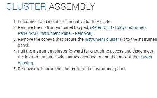

I attached the procedure below for you.

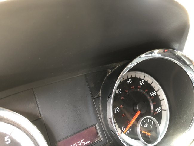

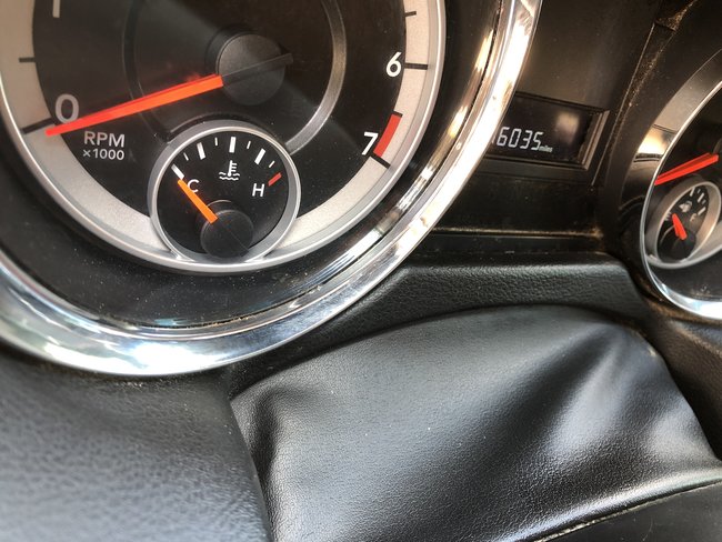

Dealer diagnosed it as bad cluster, temperature and fuel gauge not working, speedometer intermittent.

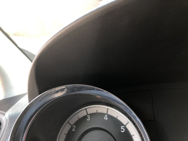

Doesn't look like there are any screws to this.
Jun 16, 2020 at 1:02 PM
Might just be some plastic clips.

There is nothing to pop it looks like part of the dash all one piece.

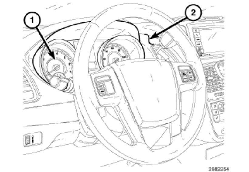

The procedure states to remove the upper pad to access the screws for the cluster. did you see that in my first post?

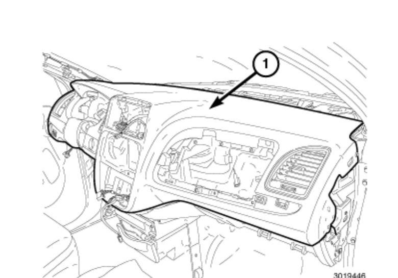

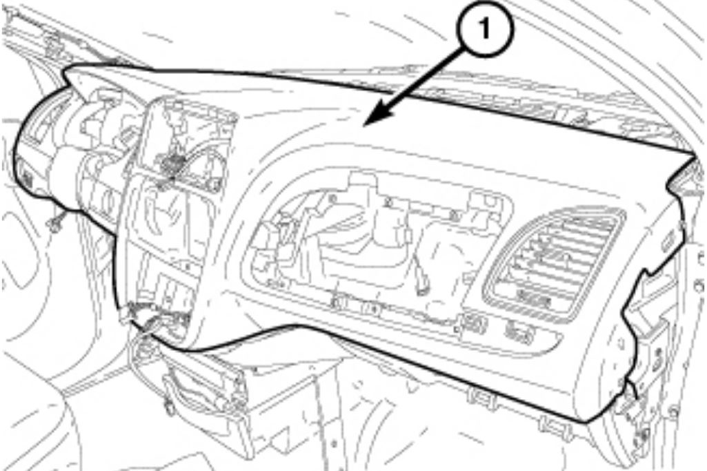

Yes, i saw it. but how you remove the upper pad? the upper pad is basically the whole top of the dash, radio, A/C display, trims.
Jun 16, 2020 at 1:14 PM
Yes, it is correct. The dash pad is the instrument panel.
I attached the instructions and pictures for you.

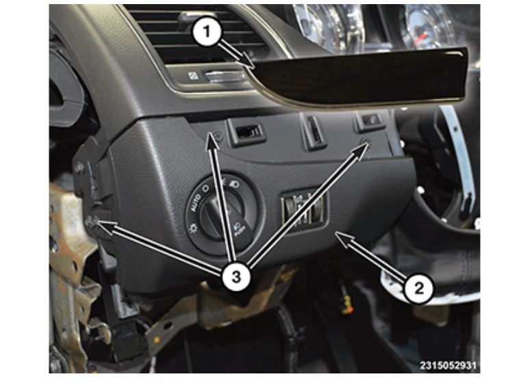

Using a trim stick or equivalent, remove the applique (1).
Remove the three screws (3) and the headlamp switch bezel (2). Disconnect the wire harness connectors.

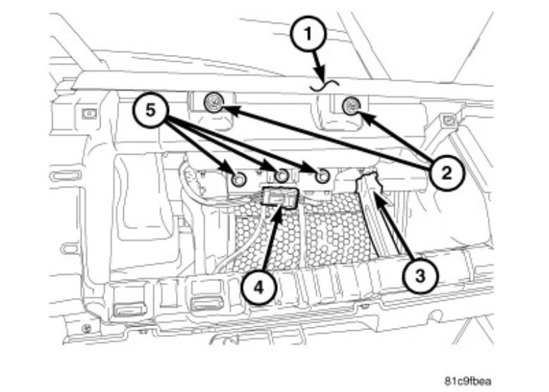

Remove the three passenger side airbag bolts (5).
Disconnect the passenger side airbag wire harness connector (4).

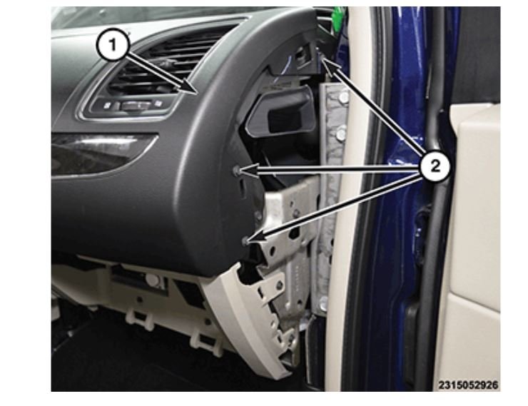

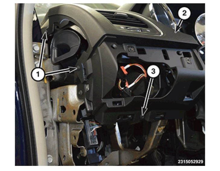

Remove three screws (2) on the right side of the instrument panel pad (1).
Remove one screw (1) located in the upper glove box opening.

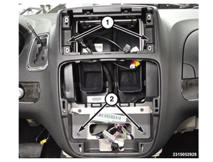

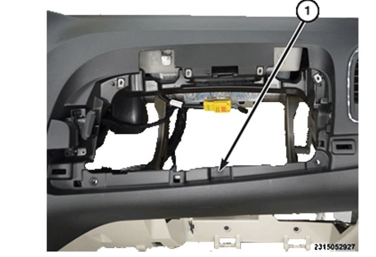

Remove two screws (1) located in the radio opening.
Remove two screws (2) located in the instrument panel center bezel opening.
Remove one screw (3) located below the headlamp switch bezel.
Remove two screws (1) on the left side of the instrument panel pad (2).

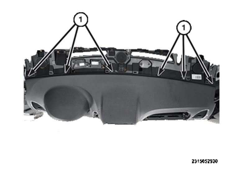

Remove six screws (1) along the top of the instrument panel pad.
Pull the instrument panel top pad (1) rearward to disengage the retaining clips that secure the top pad to the structure.
Lift upward and rearward to remove the instrument panel top pad (1) from the vehicle.

They are underneath the top dash pad shown in the pic attached, it has to come off first. Removing the cluster is almost as bad as taking out the entire dash on those vans as the only part left after getting the pad off is the dash carrier.
Don't try to use a used cluster, they are a one time unit, once programmed they are stuck with the VIN from that vehicle and are not able to be swapped, you can only use a new cluster.
