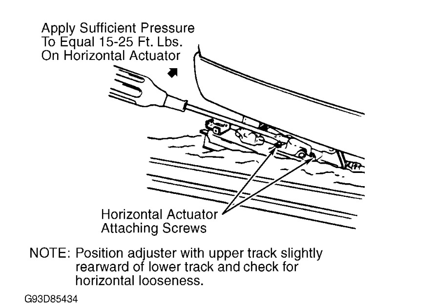

if adjustment is necessary on install :
Chucking can be corrected by adjusting horizontal actuator and pinion gear to fully mesh with lower adjuster track rack gear. Operate seat to full up position and about 3/4 forward. Loosen horizontal actuator attaching screws. See Fig. 1.
Using a large screwdriver, apply outward pressure on horizontal actuator (about 15-25 ft. lbs.) and energize horizontal switch to move seat slightly fore and aft. This keeps seat horizontal actuator pinion gear teeth in close contact with lower track rack gear teeth and eliminates free play between gear teeth. Tighten screws while maintaining outward pressure against horizontal actuators.
