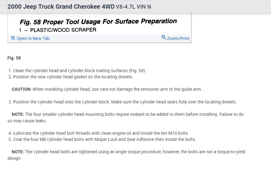

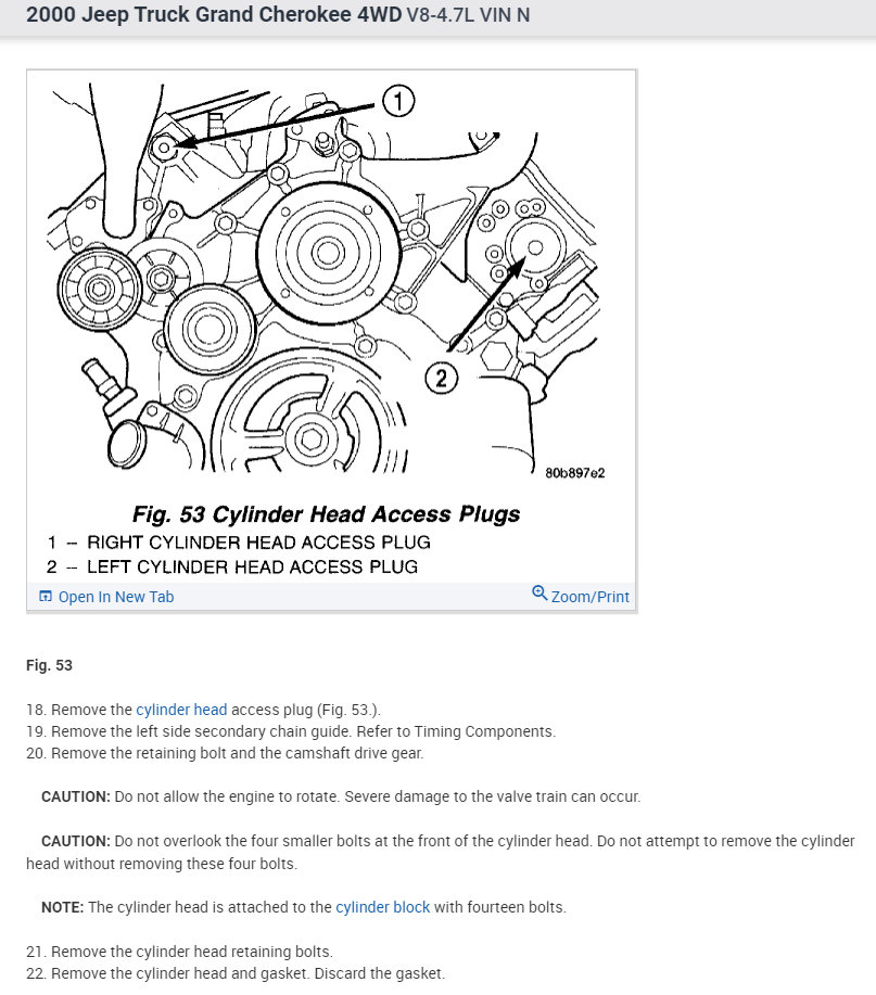

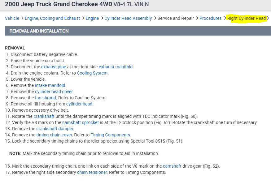

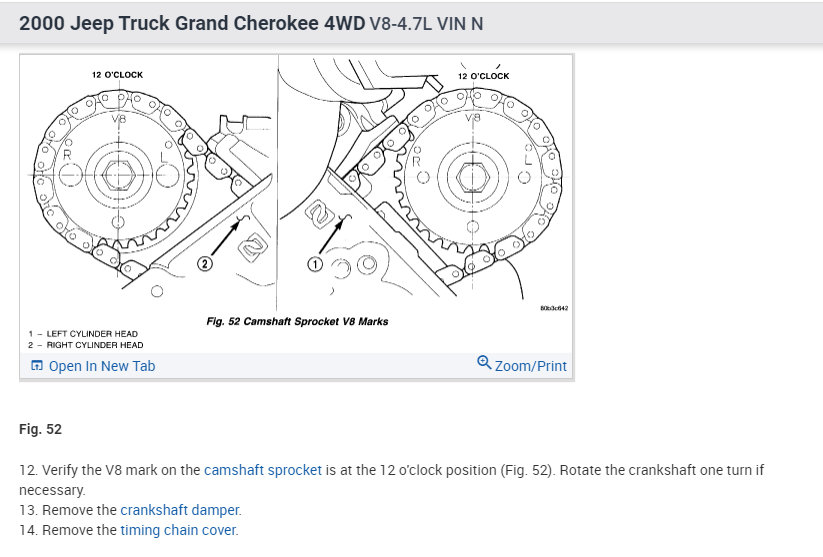

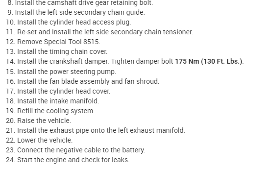

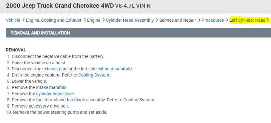

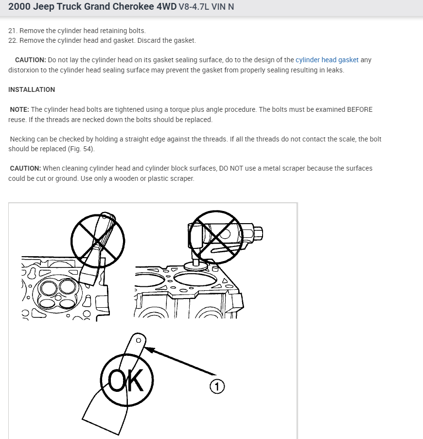

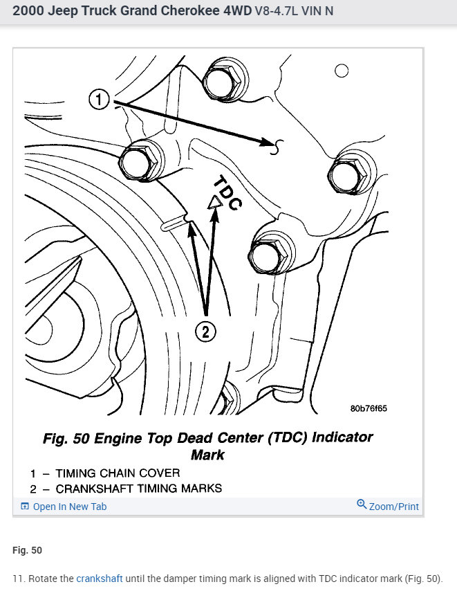

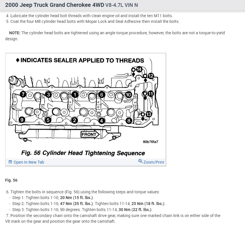

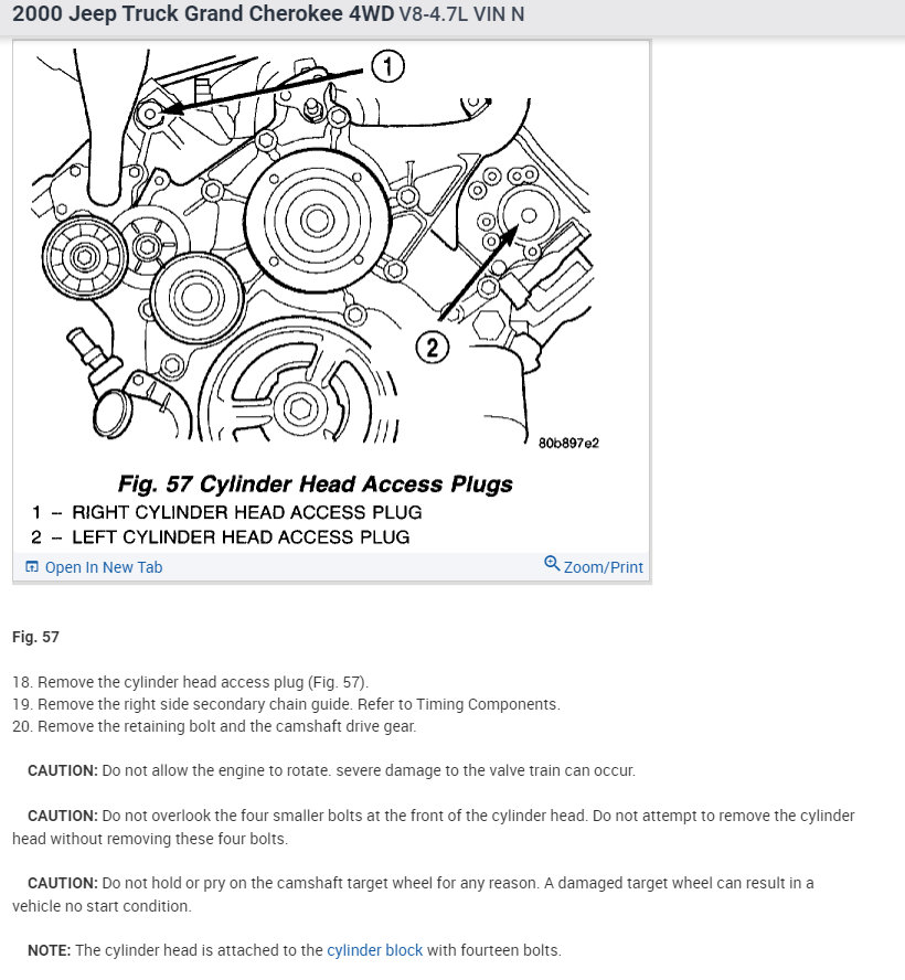

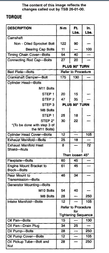

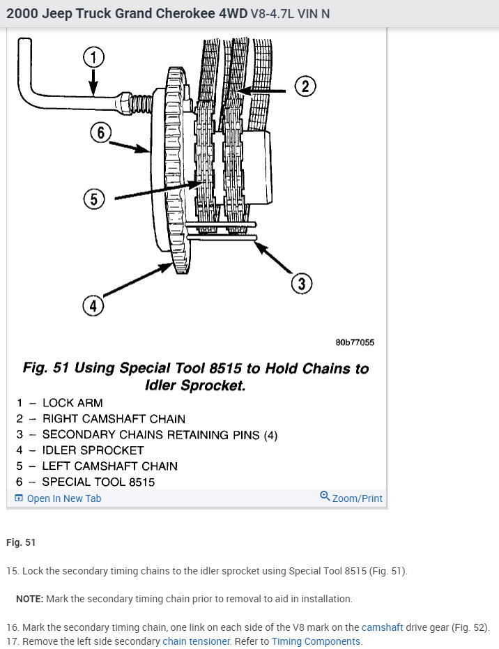

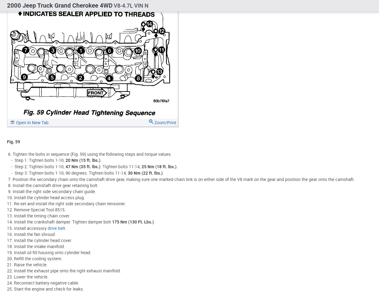

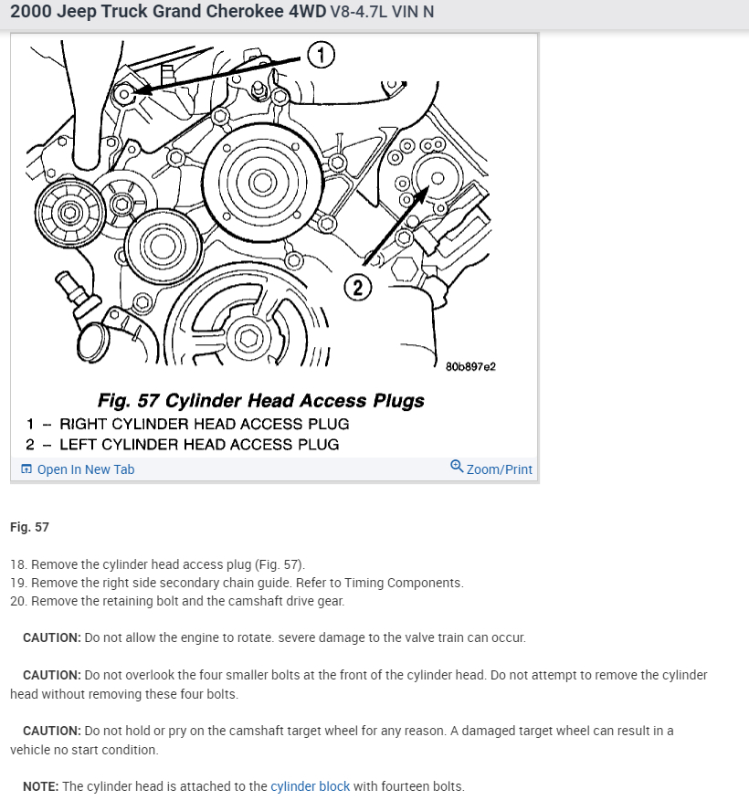

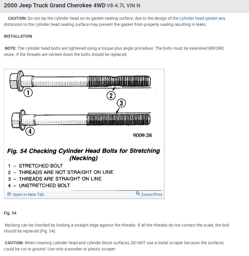

diagram of torque specs of the entire motor (rebuilding motor). easiest way to remove head safely without damage.
Jun 1, 2022 at 6:21 PM
SQM
CERTIFIED EXPERT
6,383 POSTS

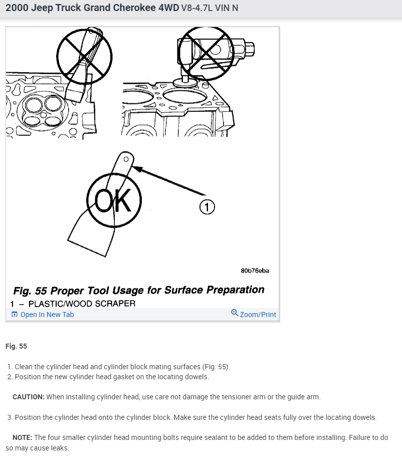

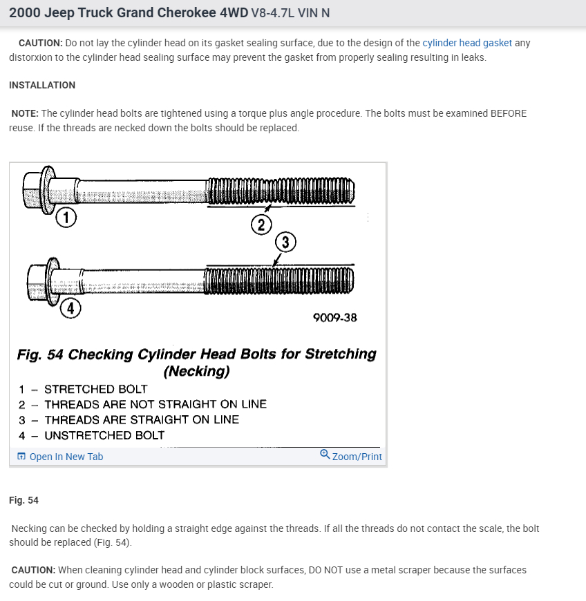

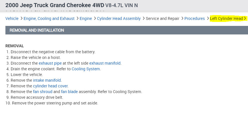

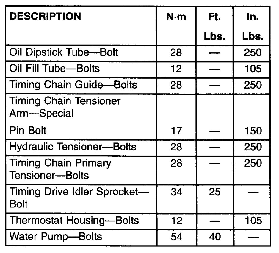

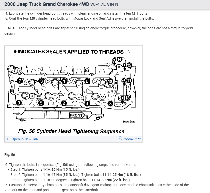

Look below, I have attached the proper procedure for the cylinder head removal and install, with the correct torque sequence. Also attached are the primary components torque specifications.
If you need to know the torque specifications for a specific item, just let me know.
