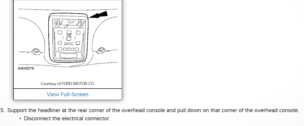

The garage door operator button on the overhead console has apparently broken and is pushed up into the console. How do I release the console and bring it down to repair or replace the4 door operator button?
Jan 4, 2016 at 10:33 AM
HMAC300
  • 48,601 POSTS

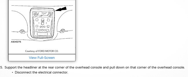

see pic these are only instructions we have
Jan 4, 2016 at 12:21 PM
RKFDJIM
Thank you for your help. Its pretty simple once you learn how. Jim
