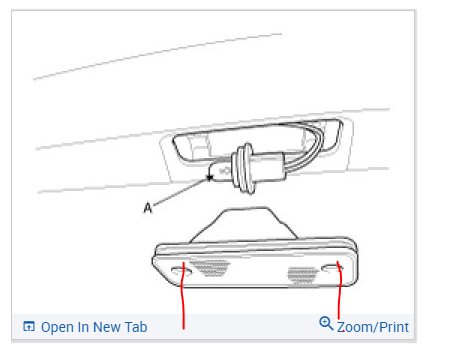

I'm not sure what melted. Are you referring to the assembly that melted? If so, it is held in by two screws. See pic below.
If that is not correct, please take a picture of what you are dealing with and upload it for me to see.
See pic below.
