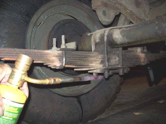

Heat the metal close to (1/2 inch or so) from the sensor, just do circles around it with the flame. this will expand the metal (and the female threads). The bigger the female threads get, the tightness on the O2 sensor male threads get looser. DO NOT HEAT THE O2 SENSOR! The cooler it is, the more contracted (smaller) it remains.
Pic below is "expanding" nuts on bolts or u-bolts to make them free up, trying to keep the bolts cooler.
This is a have the wrench ready and heat and try, heat and try. Continuing to Drag-Butt and not getting in there fast, will eventually get the Male parts hot, they will expend too, then you are not getting anywhere!
