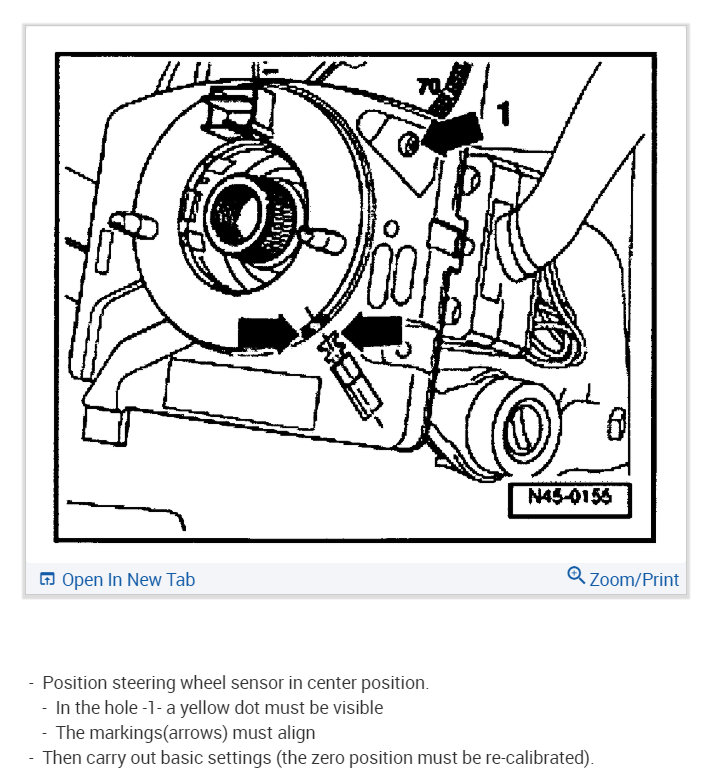

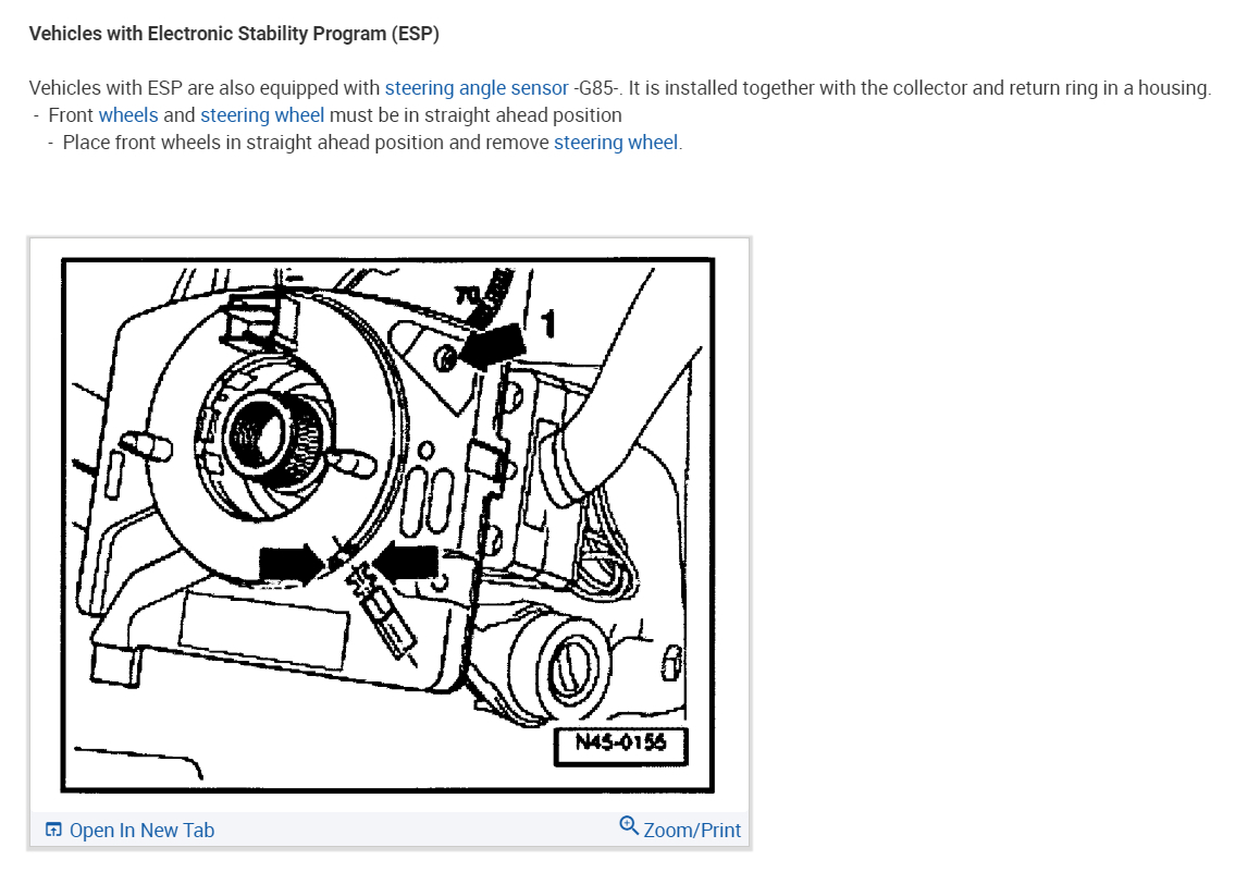

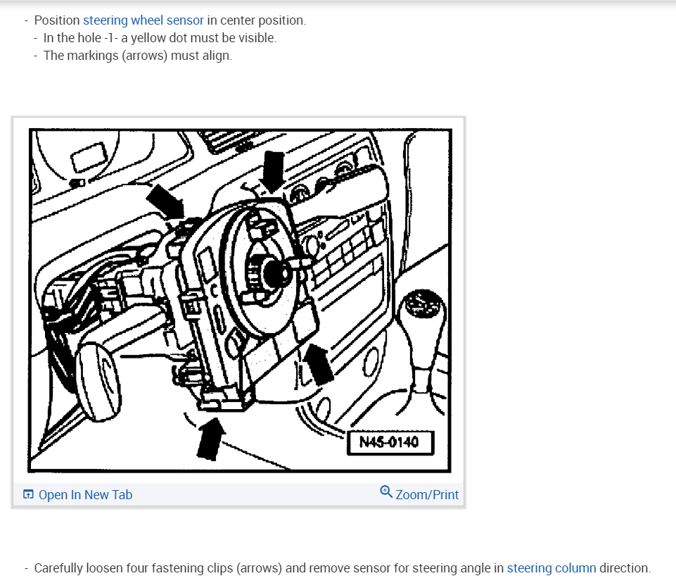

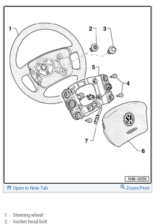

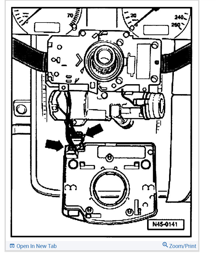

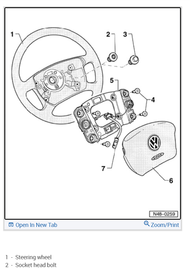

Please guide me with the steps to replace the steering wheel angle sensor.
May 19, 2019 at 2:59 PM
CERTIFIED EXPERT
53,854 POSTS
You will start by disconnecting the battery and removing the steering wheel and airbag. this guide will walk you through the steps of the airbag with instructions and diagrams below to show you how on your car:
