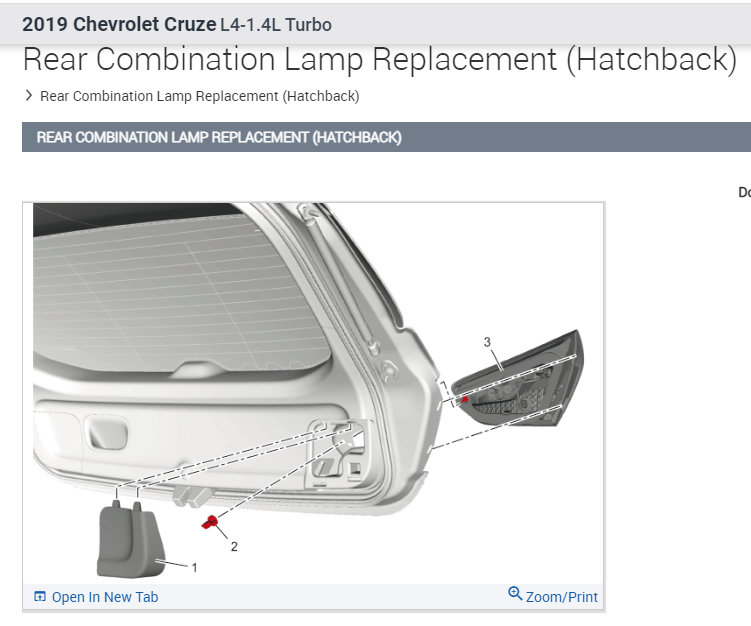

Need to remove a backup lamp on the car listed above trunk lid. How do I do that?
Aug 10, 2022 at 12:54 PM

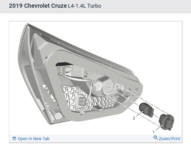

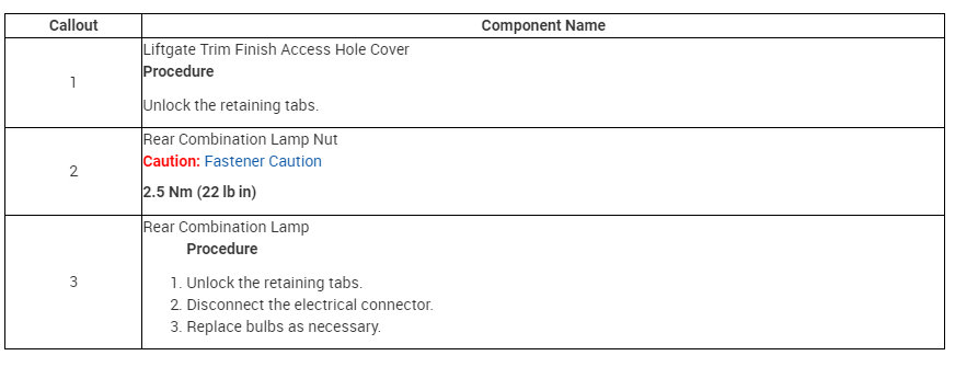

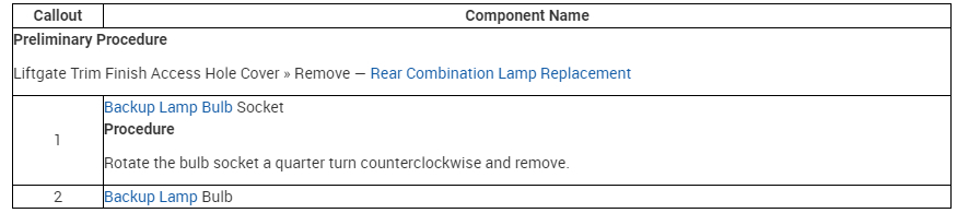

To replace the bulbs, the liftgate trim panel needs to be removed. If you look below, I attached two sets of directions. The first shows how to remove the trim panel and the second is the replacement of the bulb.
Take a look through them and let me know if they help and if you have questions.
See pics below.
